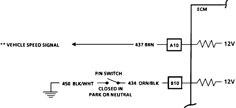

CODE 24 - VSS CIRCUIT FAULT
 Circuit Description :
The ECM applies and monitors 12 volts on CKT 437. CKT 437 connects to the Vehicle Speed Sensor (VSS) which alternately grounds CKT 437 when drive wheels are turning. This pulsing action takes place about 2000 times per mile and the ECM will calculate vehicle speed based on the time between "pulses".
A "Scan" tool reading should closely match with speedometer reading with drive wheels turning.
 Test Description : Numbers below refer to circled numbers on the diagnostic chart.
Code 24 will set if:
CKT 437 voltage is constant.
Engine speed is more than 200 RPM .
Vehicle speed signal (voltage on terminal "A9" is less than 10 mph (16 km/h)
All conditions must be met for 10 seconds. These conditions are met during a road load deceleration.
This test monitors the ECM voltage on CKT 437. With the wheels turning, the pulsing action will result in a varying voltage. The variation will be greater at low wheel speeds to an average of 4-6 volts at about 20 mph (32 km/h).
A voltage of less than 1 volt at the ECM connector indicates that the CKT 437 wire is shorted to ground. Disconnect CKT 437 at the vehicle speed sensor. If voltage now reads above 10 volts, the vehicle speed sensor is faulty. If voltage remains less than 10 volt, then CKT 437 wire is grounded. If 437 is not grounded, check for a faulty ECM connector or ECM.
A steady 8-12 volts at the ECM connector indicates CKT 437 is open or a faulty vehicle speed sensor.
This is normal voltage which indicates a possible intermittent condition.
 Diagnostic Aids :
"Scan" reading should closely match with speedometer reading, with drive wheels turning.
Check park/neutral switch diagnosis chart if vehicle equipped with automatic transmission.
If park/neutral switch is OK, see Diagnosis By Symptoms - No Trouble Codes Stored.
