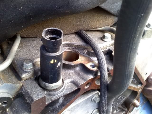

First off, what sensor is this (cam/crank maybe?) and what goes in the hole next to it?

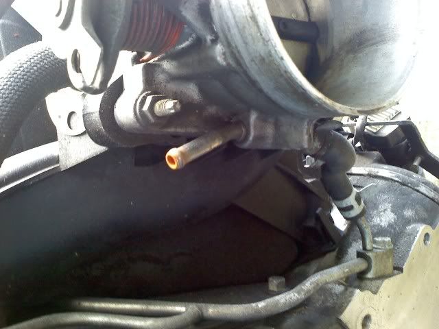

Second, im guessing this is a coolant crossover for part of the EGR (wont be running egr) where do i need to redirect it to? or can i just cap it?

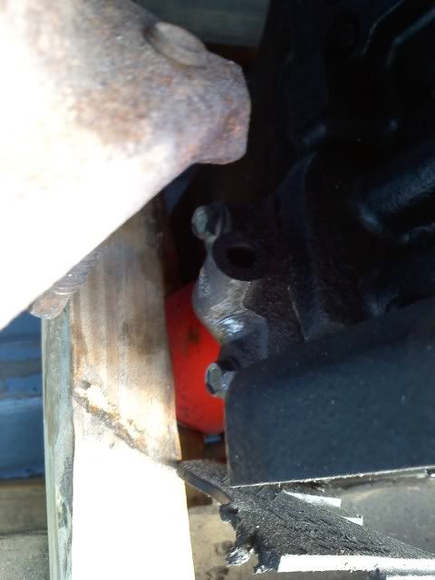

Third, what is this?

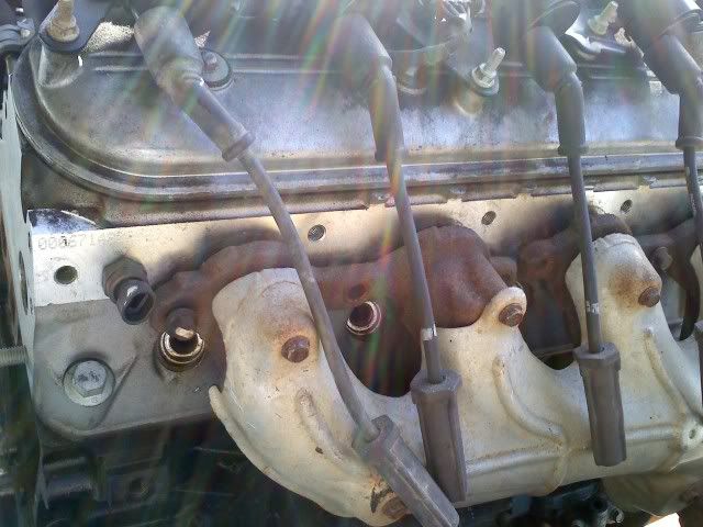

Fourth, what are these bolt holes above the manifolds for?

1) oil pressure sender
2) throttle body is heated with coolant not for EGR
3)
Quote
A dark picture of something. How about a better pic?
4) Just an assumption but for different exhaust manifolds for different applications.
and the hole next to it?
that still doesnt answer my question.
3) Third, what is this?
I took the best picstures i could. It is a block that has one hole in the top and it is directly above the oil filter.

That thing above the oil filter is like a manifold that can be drilled and tapped for a pressurized oil location.  People sometimes use them for pre-oilers, turbos, presure sender, etc.  Is it already drilled through?  If it is, you need to use it or plug it.
I think the empty hole in pic #1 is for a cam position sensor...i think.
i dont think its drilled through. it has some debri i need to cleen out of it. that would be awesome if it was for a pressurized oil spot. would work out perfect for my plans.

Yeah, I think that thing around the oil filter area is a oil relocation type deal or something like that.  I've heard of guys drilling and tapping them for their oil pressure sensor.

First, The missing hole is the Cam sensor.
Third, that is the oil passage plug.  We use those for feeding oil to the Turbos.
