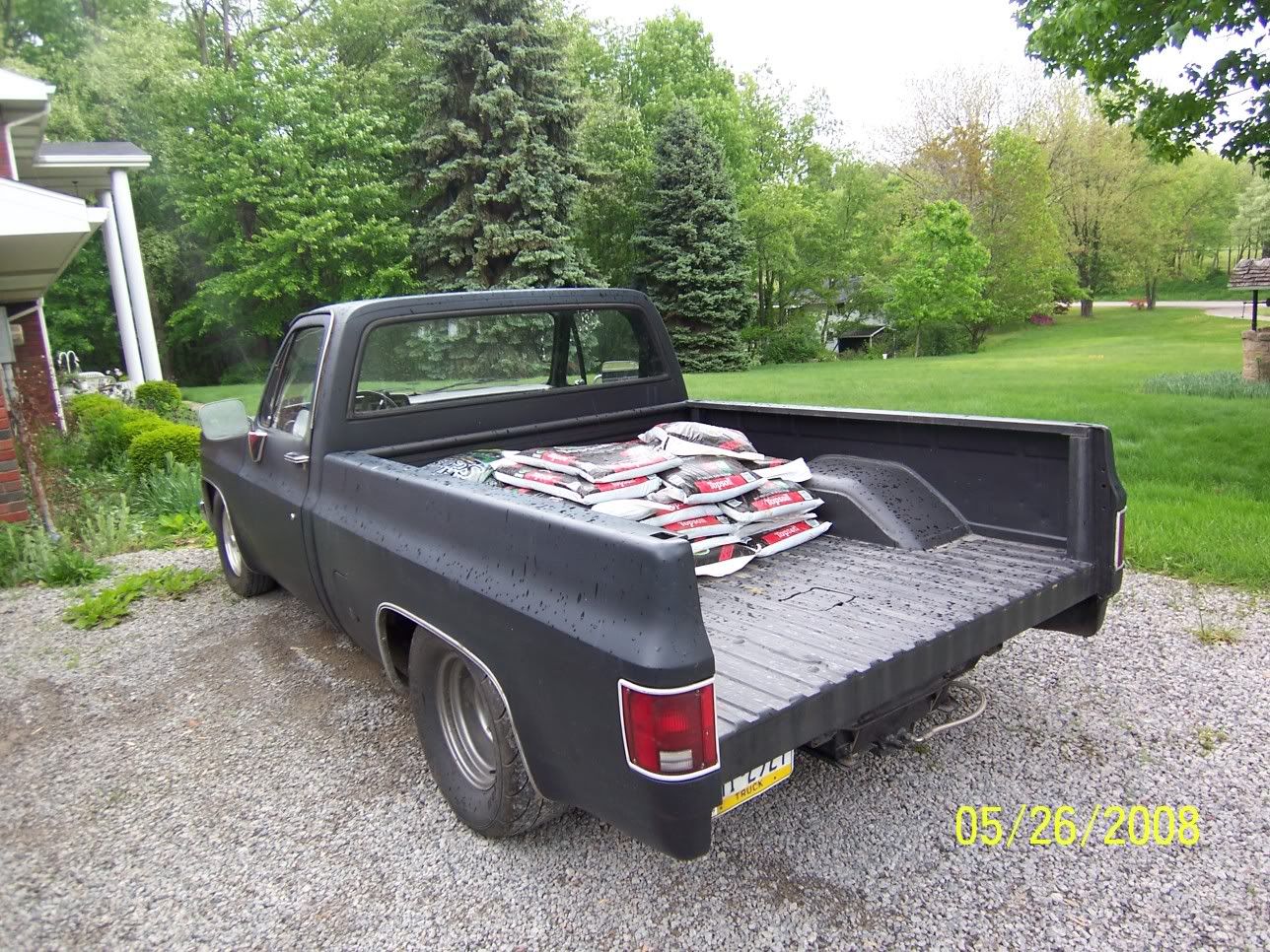

im sure there are a couple race trucks out there.
what im looking for a  a pic of  a lowered truck with a 325 under it. prefer with stock length rearend.
currently im cutting the wheel tubs and  extending them all the way to the frame.  and  im trying to figure if a 325 will fit without  cutting rearend down.  and  fliping the  leaf spring to the inside.  i searched for it and only found one truck with a 325 under it.  but it didnt ahve a bed. all the other trucks were stock height. and tire looked to stick out a little.

Here ya' go...325/50 on a stock rear. The tubs were just widened back to the springs & they don't need moved.
 I have since changed to a 9", I made the total track width 2" narrower using the same tires to get the sidewall off of the inner bedsides a bit. Lorne
