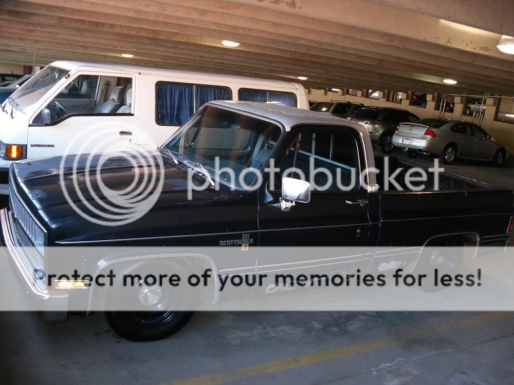

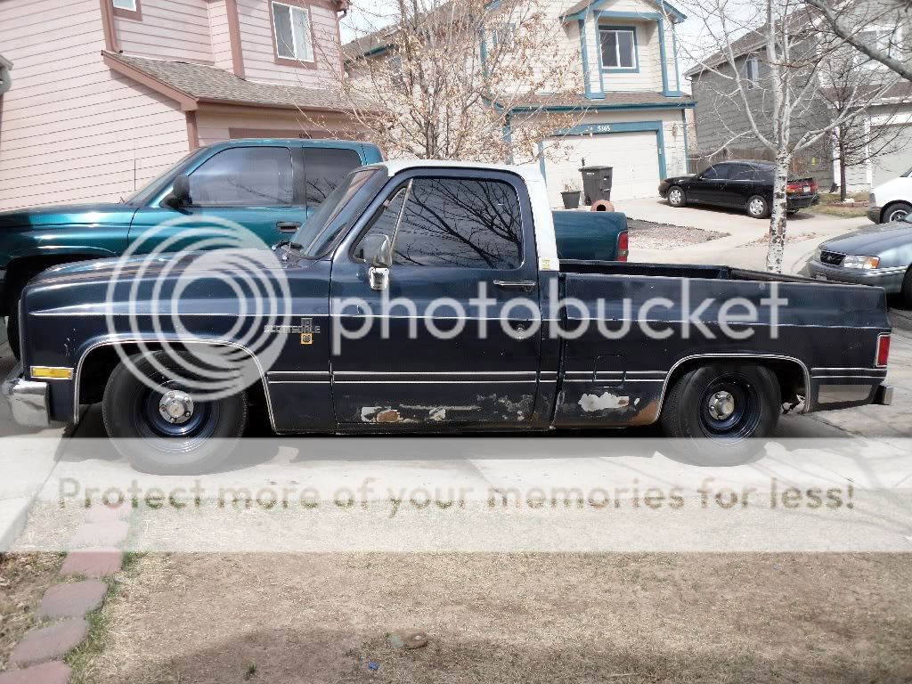

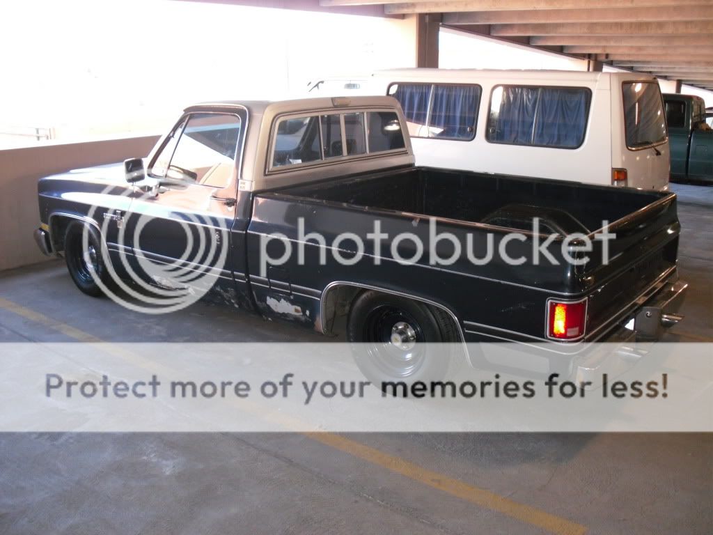

It rides pretty good actually! Im pretty surprised. Ill put pictures up tonight and yes the rear is flipped and notched. If the notch was any bigger there would have to be a hole in the bed. The front is just spindles and springs.

Looks like a 3/5 to me. If it is a 6/7, you couldn't have been stock height before the drop.

Hmm, the guy that sold it to me said it was but he was kind of a moron haha. Maybe you could show me a pic of a truck that you know for sure with a 6/7. Thanks!

Not a 6/7 drop.  6/7 drop would required cut springs and spindles and it would ride like crap, and the control arm would be skimming the road.  If the roads were bad you wouldn't be driving it and be happy.
