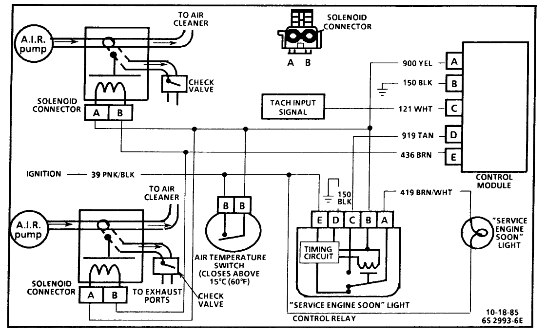

« Reply #9 on: April 13, 2010, 05:19:27 pm »
How about some pics of your set up under the hood so we can see what you're equipped with? Look behind the glove box for the ECM. You have no data link connector. If you follow the diagnostic strategy I posted you should be able to pinpoint the cause of your CEL.
