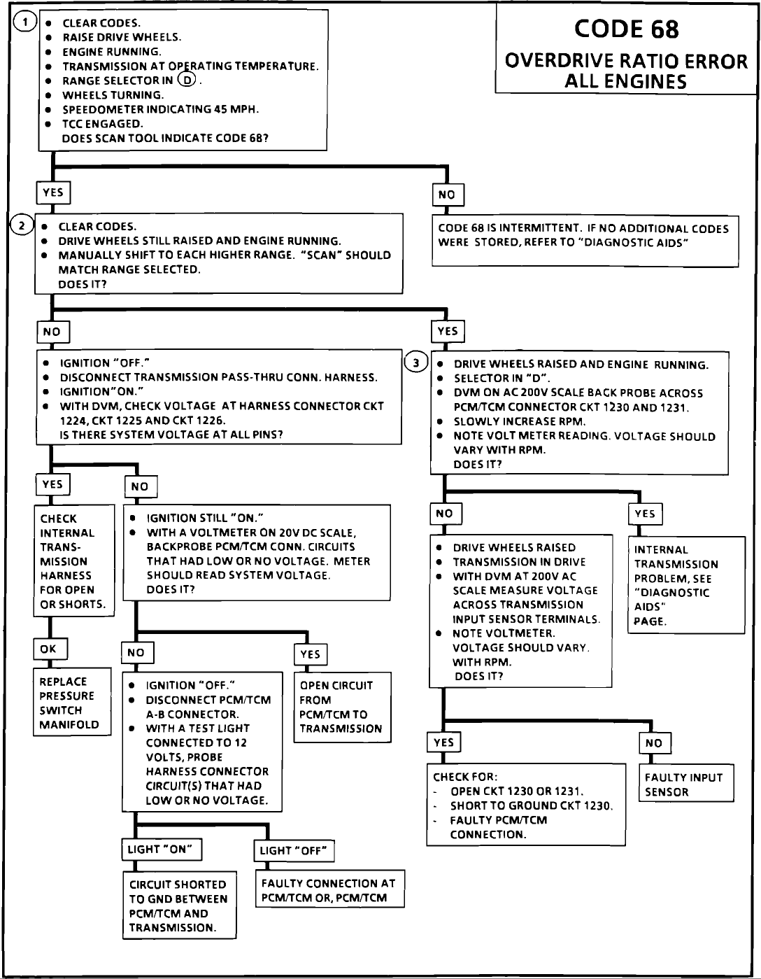

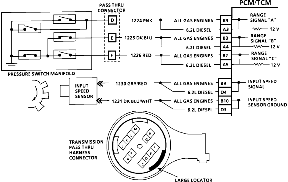

« Reply #10 on: June 01, 2010, 04:57:24 pm »
The first thing I would check is your tcc brake switch and the harness connections/wiring. From there follow this diagnostic strategy
Circuit Description:
The PCM/TCM continually monitors voltage on each circuit connected to the "quad-driver" for either low or high voltage, depending on the commanded state of the device connected to it. Code 83 will set if the PCM/TCM detects an inappropriate reading on the TCC circuit. For example, if the TCC duty cycle is 0, but voltage on the TCC circuit drops as if the solenoid were applied then Code 83 will set. The TCC solenoid, because of it's large current draw, is connected to two terminals of a single "quad-driver."
Test Description:
Number(s) below refer to circled number(s) on the diagnostic chart.
This test checks for low resistance in the solenoid or internal transmission harness. The test also determines which circuit triggered the fault.
Diagnostic Aids:
Be sure to check all connections, especially those at the transmission pass-thru connector.

« Reply #11 on: June 22, 2010, 03:09:52 pm »
Just getting back to this but code 68 is intermittent.  So what is the "Diagnostic aids"
Re: 4L80E lost 4th gear
« Reply #12 on: June 22, 2010, 05:00:21 pm »
Basically the first things I posted there. Check the brake switch, the connector, wiring, pin tension, unwanted voltage drops etc.
