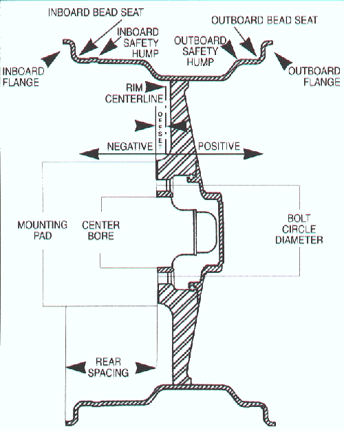

BACKSPACING
"Back spacing is the distance from the mounting surface to the rear of the rim.  For example 4" backspacing will measure 4" from the mounting surface to the outer edge of the wheel if you placed a straightedge on it." Captkaos
Offset is not the same as backspacing.while backspacing measures from the mounting surface to the edge of the wheel, offset measures from the mounting surface to the middle of the wheel (when it's standing vertically)
The easiest way to measure backspace is to lay the wheel face down onto the ground so the backside of the wheel is facing up.  Take a straight edge and lay it diagonally across the  inboard flange of the wheel.  Take a tape measure and measure the distance from where the straight edge contacts the inboard flange to the hub mounting pad of the wheel.  This measurement is backspace.

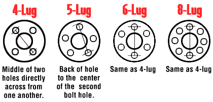

LUG PATTERN / BOLT CIRCLE
"Bolt circle is the diameter of the circle that the bolts are centered on.  GM pickups are 5 on 5".  Or 5 lugs on 5" bolt circle."
