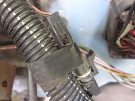

I do have headers on the truck, and yes, I did put an o2 sensor in. However, I'm getting an o2 sensor circuit code and I did get a lean code too...I don't have a chip, so right now it thinks it's a stock 350. I'm not sure what the shop set the timing too, I'm assuming 0 degrees... And I'm getting a steady 11.5psi for fuel pressure. Is this the wire I'm supposed to unplug to time it?

« Reply #5 on: August 03, 2010, 01:09:58 pm »
Here's a post with some related info.
http://forum.73-87chevytrucks.com/smforum/index.php?topic=16688.0
There was a post not too long ago where somebody had a picture and pointed out which wire you need to unplug. It was in the same vicinity as the wire in your picture. You can hook up your timing light, let it run and unplug it and you will see the mark on the balancer move several degrees if it's the right one. Then set it to 0.

Unofficial: I am not sure if that's the wire, but I think so.  What you're looking for is a tan wire w/ black stripe that goes directly to the module located inside the dist.

On my 88 the timing connector is right over the PS valve cover but there's a junction/distribution block there and it looks as the one posted below looks just like it and I thinkit is tan and black striped.

That is the EST timing connector. Disconnect it with the engine off at operating temp. Restart it and set the timing at 0°BTDC . The cam you used which I apprently recommended  ??? is just slightly larger than stock and shouldn't even require a chip to solve your issues unless you are running a 305 prom. Get that fuel pressure up, verify no vacuum leaks. Make sure you are using the right injectors and clear the codes after you set the timing.
