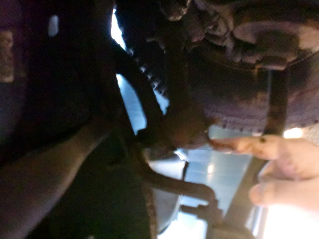

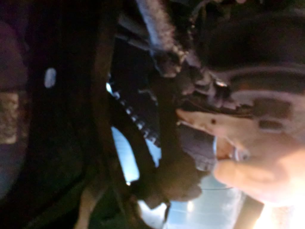

ok I put on my winter rims this weekend and i noticed some play in the steering system. When i press on the tire front an back the part in the pictures below deflects upwards. I think its called the idler arm. Anyway the first is the point where it rotates upwards, the second one im pointing in the direction of the deflection.
do i need to relace that part? or is it something like the tie rods doing it? i dont know what to check.
any help would be great.
thanks

Idler arm and yes you should relpace it.
