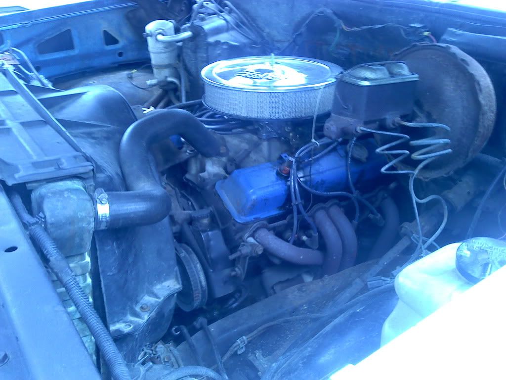

Offline Millerk10
  • Posts: 7
Re: 79 k10 converting from auto to 4 spd
« Reply #4 on: November 17, 2010, 08:48:52 am »
Offline 78 Chevyrado

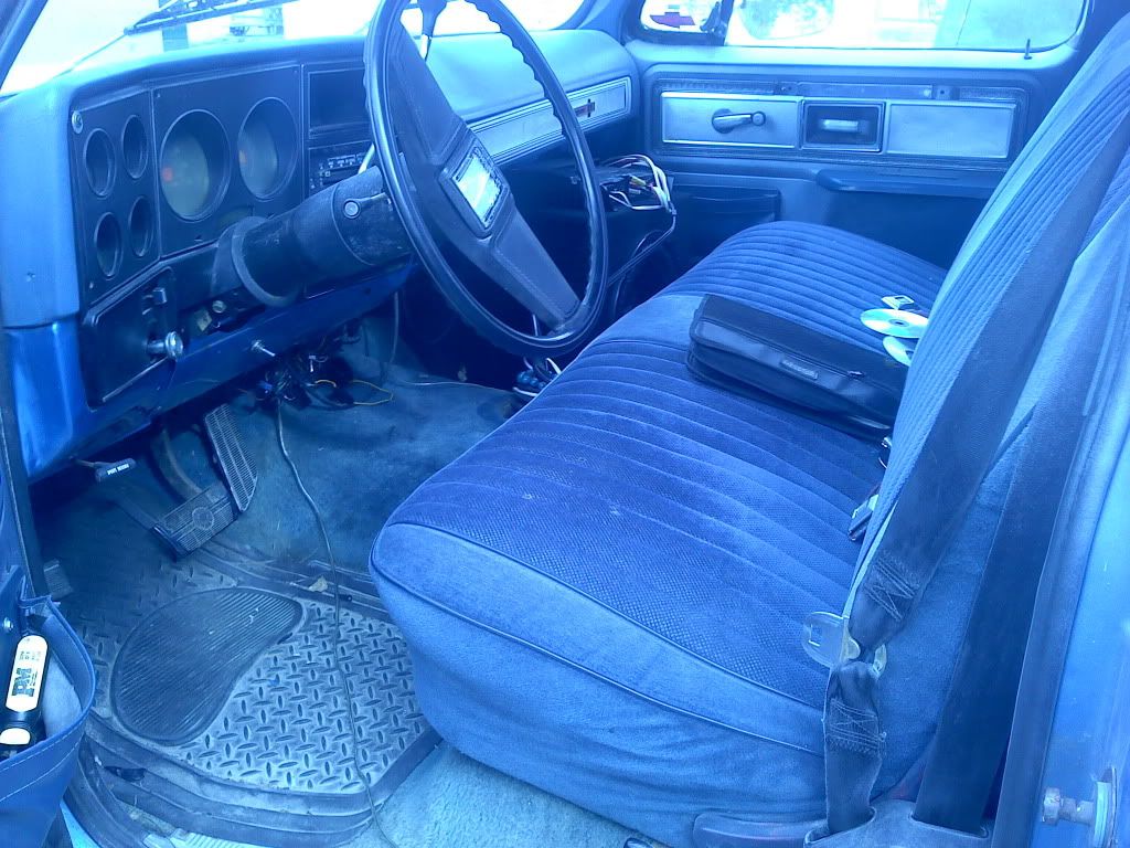

« Reply #5 on: November 17, 2010, 09:06:23 am »
I think the hardest part of the swap will be setting up your auto trans cab for the clutch pedals.  you'll have to sway the pedal brackets from the manual trans cab to the auto trans cab, its doable, just inconvenient.
