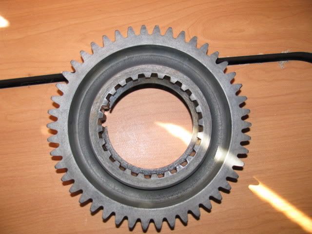

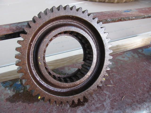

Best thing for removing rust, I drop em in vinegar for a few days and give em a rinse with baking soda and water.
Before
After
