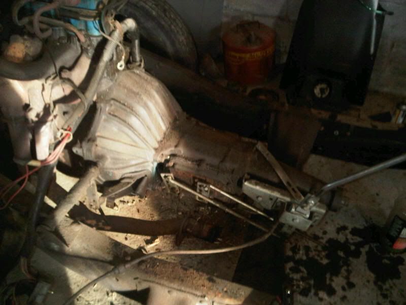

on the truck i bought someone did the switch, i dont know what brand it is but it worked.

I have a Hurst shifter that works just fine for me. I think this is the one. Came with the truck so im not positive.
http://www.summitracing.com/parts/HUU-3838520/
