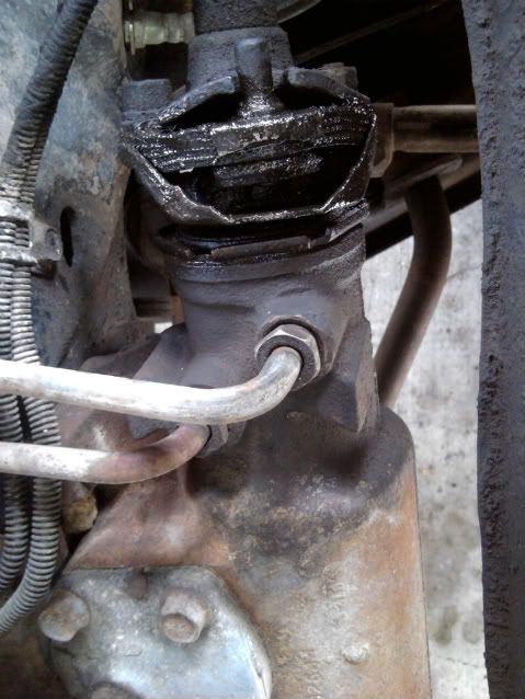

can anyone tell me what I need to do to fix the part in the picture? Are there just worn gaskets or orings making it leaky/wet right there?
Re: power steering only works when car is moving.
« Reply #3 on: March 19, 2011, 07:22:58 pm »
just a bad seal, but the word on rebuilding them is that it is a pain in the but. I suppose if you had a back up box, there is no reason not to attempt it if your willing to spend a few more bucks for the rebuild kit. they did it on powerblock tv and it didnt look too hard. but that is TV.

haha well i've never rebuilt one. i guess i'd rather do that than spend 200 on it. think there are any how tos on here? im not even 100% sure what that part is called.
