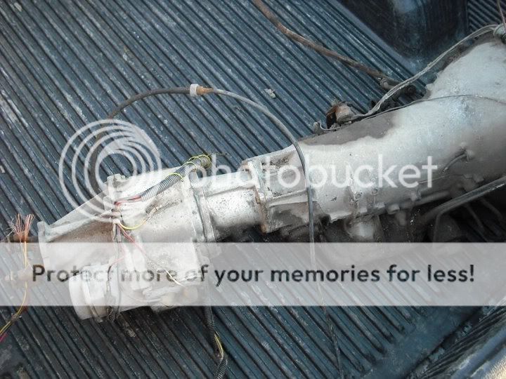

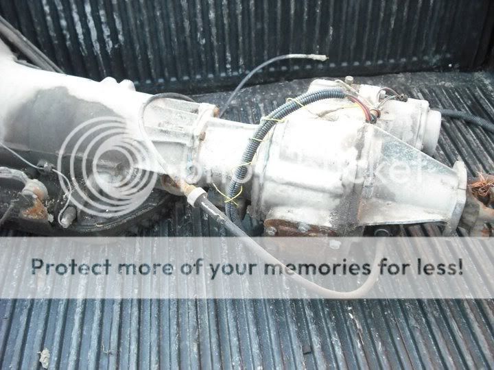

As requested here are the pics of the overdrive I removed. Let me know anything you guys know about it. Sorry it took so long, but I am a full time college student; got home, and internet has been down. So now im back at school posting.

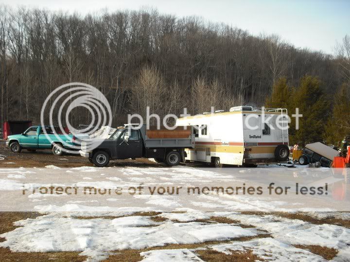

Pre Tear down of the southwind, the 88 ready to load.
Tear down
and here is what my truck looked like after towing it home down the road from a neighbors house...The camper was sunk in the ground pretty good, and my yard was a mess, so...so much for having a clean truck.

Any ideas on this yet? It looks like it could have a pto added on the side.

Unless one of these falls into your lap an O/D unit isn't worth it. You can build a 4L80E for much less $ and less weight. Many motorhomes came with overdrive units.

I have seen several types of over drive units in older motor homes. I don't know for sure but I always thought they were something the coach company added after they took delivery of the chassis.

Could it be a th475 with a transbrake? Iv heard of them in motorhomes but never seen one so idk what it would look like

It could be a TH475, but a trans brake is internal.
If your talking about a TH475 with a out put shaft emergency brake it would have the brake drum behind the overdrive unit on this particular one.

Zeig's right- Here's a closeup pic of a gearvendors unit- they cost @ $3500.
