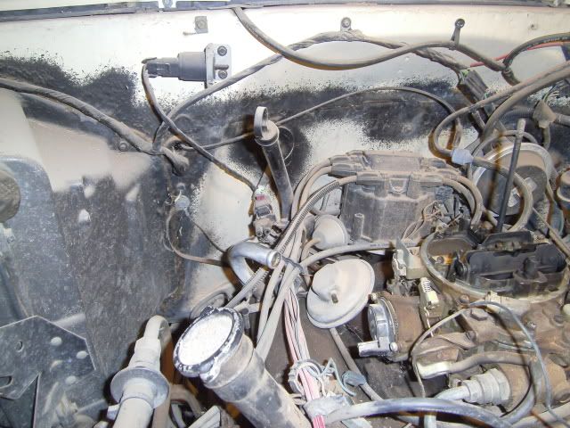

Ok, so far so good. I have a few questions just to make sure I understand right. I searched for the answers but the number of 'rabbit trails' the conversations took kinda got confusing.
The first ne is verifying this switch is for the torque convertor lockup, and that I am tying the vacuum line to intake manifold vaccuum, correct?
The switch in the top left corner of this pic is the ESC tip in switch which I can make disappear and hide the wires in the harness.
The last switxh that I am unsure of is the one on the rear of the right valve cover. It had two vacuum lines going to it.

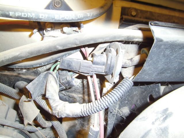

Re: Oh happy day
« Reply #6 on: April 23, 2011, 09:00:38 am »
better pic

Not really sure what you are trying to point out? If you are trying to ID all of your components compare them to the schematic.

Sorry, Im just trying to make sure Im on the right path with what Im trying to do.
In the pic with the yellow circle, am I correct in the fact that it is the ESC tip in switch that I can remove. The vacuum switch in the red circle is one that I am not sure of what it is wand what to do with it.
And last I want to verify that the vacuum switch above the brake booster is the lockup switch for the torque converter and i run the vacuum lime to the intake for its vacuum supply. The link you showed me show the wiring for the heater/a/c controls.
I was looking at the schematics earlier but could find what I was looking for. Not saying it wasnt there, I just couldnt see it.
On my way now to rebuild a carb for it to get rid of the electronic solenoid carb, and rewire the ESC distributer to convert it to a normal one. Then cleanup and paint.
