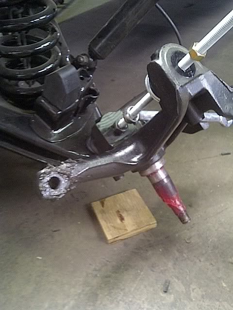

I read about this on here.  Took a couple pics when  I put the drop spindles on.
Take a piece of 3/8 tread stock and basically put a nut on it under the top of the spindle and tighten.  The lower ball joint will pop out pretty easy.

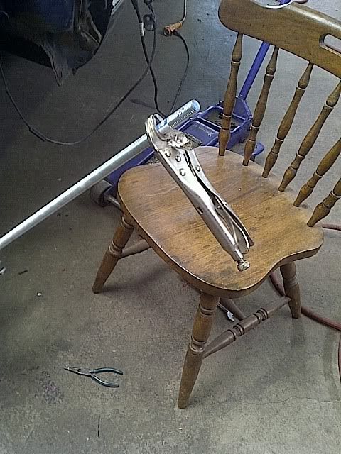

I put a vice grip on the end of the stock and assisted in the turning.
This is really simple to do.
