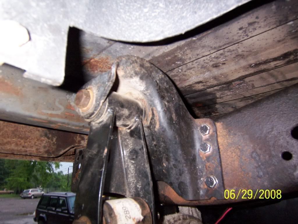

Welcome to the site! I've got a couple thoughts to share with you. It all depends on how low you want your truck to sit & what you plan to use the truck for. At first, I added 2" dropped shackles & removed all of the rivets holding the 4 brackets to the frame & dropped the frame down until I ran out of bed floor clearance, checked the pinion angle & drilled some holes. This lowered the rear of the truck about 3 1/2".
 This worked fine however after researching some theory in leaf spring placement for drag racing...the placement/angle of the spring wasn't ideal this way so I put the front mount back to the stock location, did a flip on the axle & turned over the rear hanger (which sounds like what your describing). This works very well & there is no need to use the Suburban hangers, just turn over the ones you have & drill. You will need to move the hangers forward on the frame to achieve the proper shackle working angle.
So if 3 1/2" or so is what your after, I would do the first option. If your wanting closer to 5"-6", do the flip & see where your at. If you plan to haul much weight in the bed or pull a trailer, ect. your going to need some more clearance between the axle & the frame than the guy who uses his truck for a nice night out.
Here's a couple pictures of the rear hanger/shackle. You can see in the first picture where the hanger used to be. Lorne

I used suburban front spring perches and McGaughys 2" lowering shackles. used one of the 4 holes on the subruban hanger, and redrilled the other 3. the subruban hanger holes has a different bolt pattern..
clint
for comparison is the last photo
