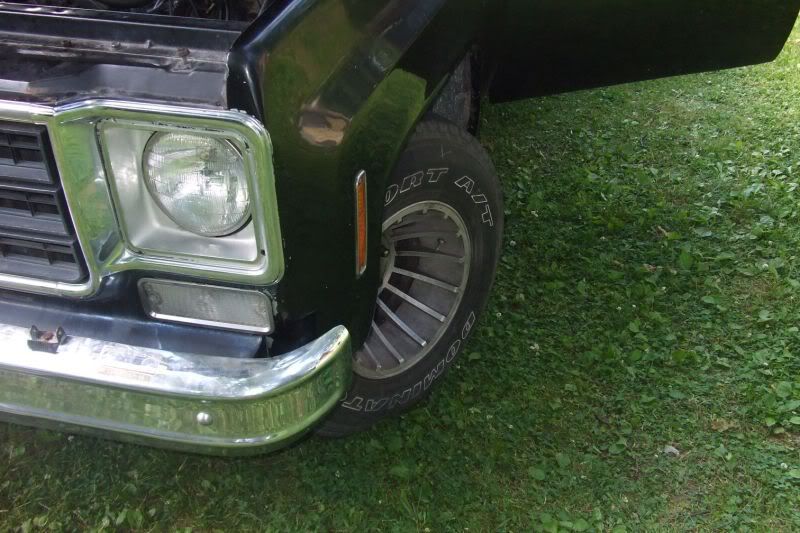

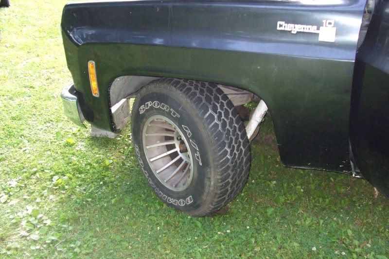

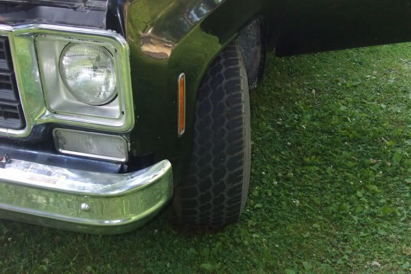

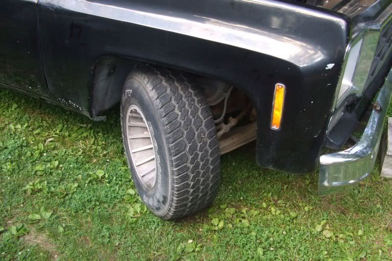

Here are a few pics of the wheels and how they look turned lock to lock. Does anyone think these wheels should be turned more? Notice it turns sharper to the right.
FULL LEFT
RIGHT
LEFT
RIGHT
ONE MORE RIGHT
Last Edit: June 25, 2011, 07:38:37 pm by 76StepSd
Posts: 19255
Re: Steering lock to lock seems to short
Reply #12 on:
June 25, 2011, 10:17:06 pm »
It's called toe out on turns. If your alignment is correct and the geometry is stock you should have no problem negotiating left and right turns.
