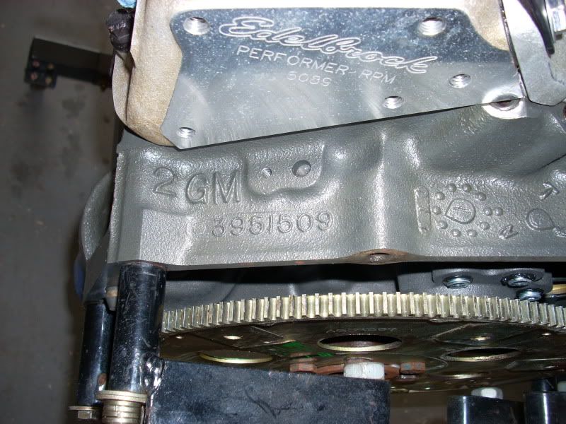

« Reply #7 on: July 10, 2011, 02:04:37 pm »
i will make this VERY easy. find the # on your block that is shown in my pic. then internet search it like on nastyz28 or similar places....
