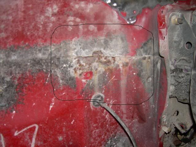

The last cab I used had the same problem but was rust free on the underside so in my opinon was worth fixing, especially where I am from.  It was a lot of work to get rid of it.  Once I got digging into it things got a lot worse but is all good now.  I decided the whole problem was whoever caulked the seam at the factory was asleep for about 6" of the seam and let water and leaves under the caulk.  I spent a lot of time digging the caulk out before I got started, very time consuming.  Couple pics of my buddy helping me weld it up and one of it done.

nice work man very nice

I had some similar problems especially since florida`s coast eats up some metal as well.I been on this cab for quite some time here n there and here are some pics i had to deal with.
All the rust is finally fixed, and i welded up the pinch seams nd removed all that seam sealer junk  and used some USC all metal and now i`m here till hopefully in a week or 2 then be done with the firewall...

« Reply #11 on: November 29, 2011, 01:32:38 pm »
I'm going through this same problem right now with mine. How did you go about forming the metal in the firewall area that was concave for the engine. Did you just tack the piece in and use a body hammer it into shape or what ?
Why did you fill one hole for the heater box and not the other?
