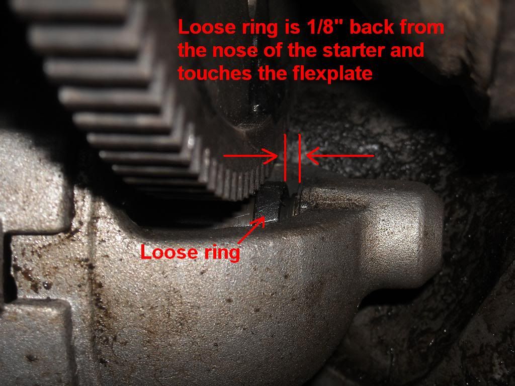

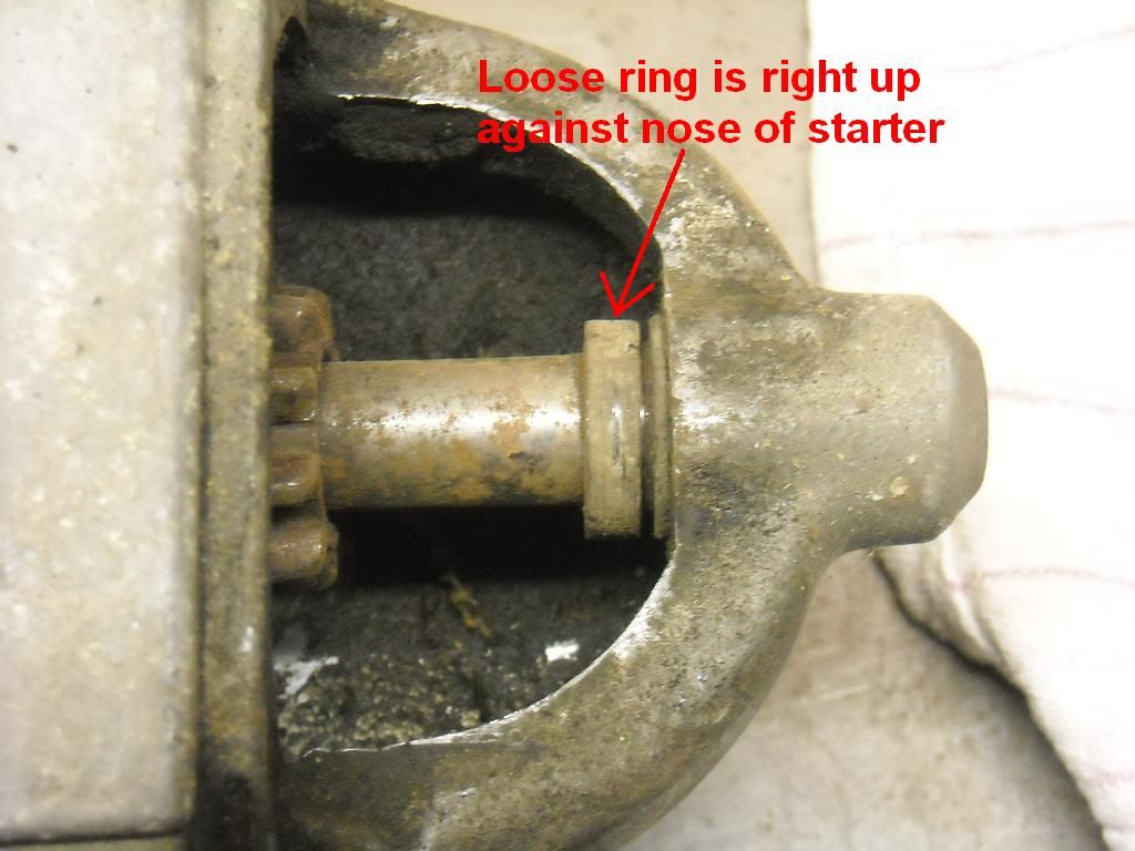

I pulled out an old starter I had (shown in the first picture) and this loose ring seems to be contained way at the nose end of the starter gear shaft where as the loose ring on the starter in my truck now (shown in the second picture) seems to be able to slide away from the nose of the starter and go toward and actually touch the flexplate.
Anyone have a starter they could look at to see how far this little loose ring can move?
Pic of old starter where the loose ring is contained way at the nose end of the starter.
Pic of the starter installed in my truck now. The loose ring is actually touching the flexplate.

I just looked at one for you. The one I had is about an eighth of an inch away from the nose.
That loose ring is a stopper for the starter gear to spin on I believe. It should not touch the flexplate. Sounds like you need to shim your starter down.

That little "ring" is a retainer that cages the snap-ring that, in turn, holds the drive on the armature and controls forward travel.  It shouldn't ride that far away from the starter nose.  You need to check:  1) the end-play on the armature (there shouldn't be any more than about 1/16", 2) the "ring" should spin easily, but not move forward or backward along the length of the shaft (the "ring" snaps tightly over a 1/8" thick "C-clip" to retain it around the shaft - make sure the C-clip is there!), 3) check the side-to-side play of the shaft in the nose bushing (should be negligible - can't feel any).  Take a look at these things and report back.   :)
