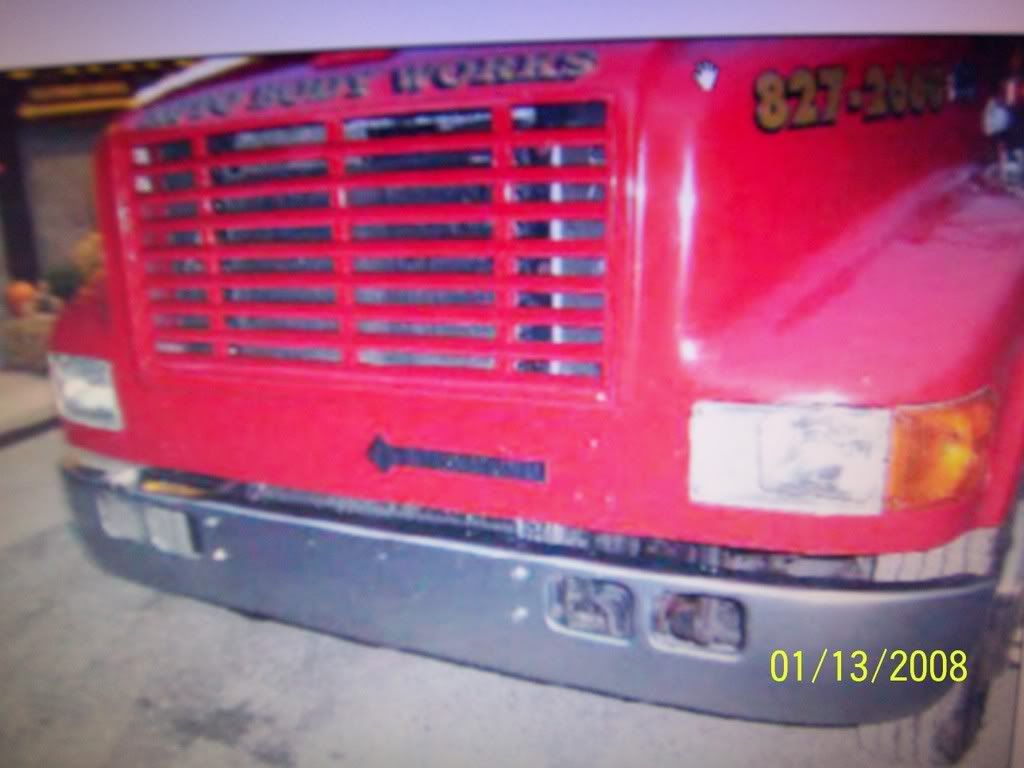

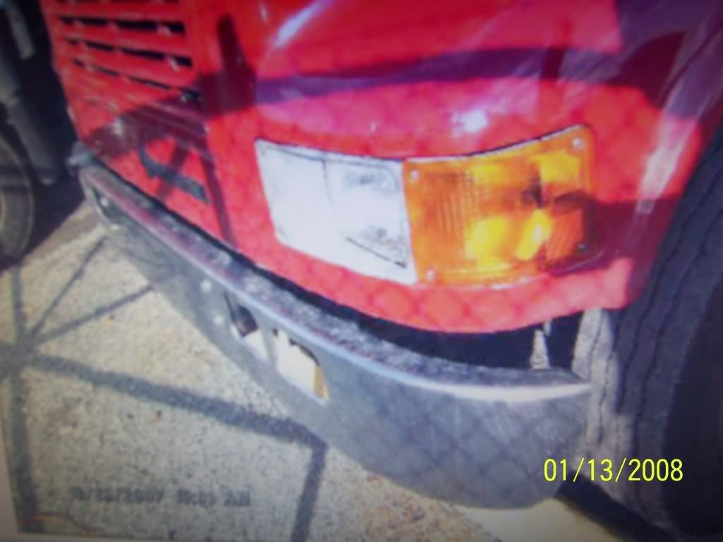

I've played with House of Colors "Spray Chrome" a couple times. It would work well for things like the dash bezels, int. trim, ect. What I found was the more curves, grooves, pockets, ect. the better & more realistic it looks. It is VERY difficult to get a large flat area (more than a foot or so) to look close to perfect...The "Silver" is VERY transperent & smudges or even static, ect. are magnafied as darker areas & can ruin a nice piece. These problems show up much less on the smaller or highlighted items like you are thinking about.
Here is a bumper I did for my truck a few years back. Being big & flat, it really didn't look so much like chrome, however the effect was really nice...it looked more like polished Aluminum or Stainless to me. It sure beat the dull & rusty Gray that it was before painting it. Lorne
