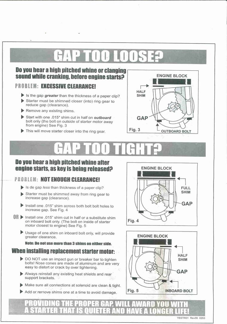

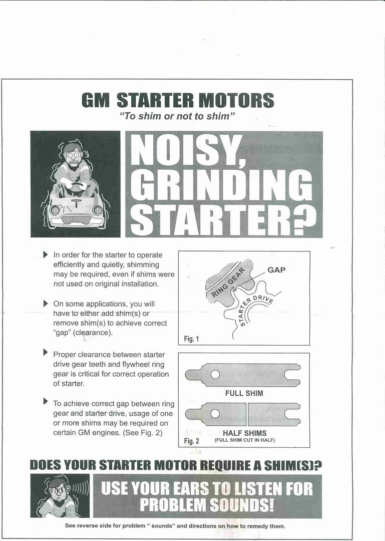

Not sure how to add to the pre-existing shim thread in the tech section, but i thought i would offer these before i chucked them:
This is the second page to the gm handout (as well as the first).
i think if you click on them you can enlarge them?

Page 1 is already in the tech section, but i couldn't add page 2 to it so i posted it here.
