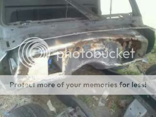

Found my tools at the pawn shop other day so decided I would start cutting out old firewall.
Got to fix inner structure then I can do firewall, hopefully will get all templates made this week so I can cut repair pieces this coming weekend.
