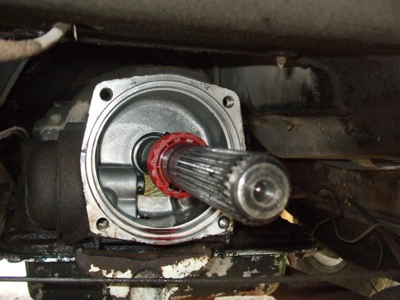

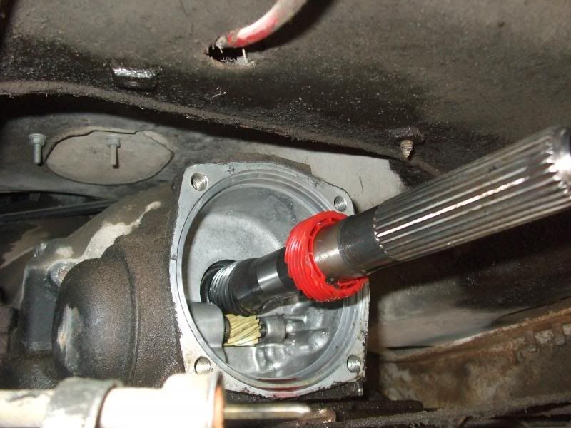

my cup is missing i took the tail shaft off to change that "O" ring and nothing but a shaft and tail shaft housing....i mean....do i have to pull the shaft out or what? Never done this before anyone have any ideas?....i am sure you do...:-) 76 Step side C-10 with a i believe early 80's R700 non electronic. will take some pics in a bit.

here at the pics

The "cup" just slides over the shaft and then tap it into place on the smooth "band" area just behind the speedo gear. You do not have to remove the shaft.

I had mine off recently to change the speedo gear, so it will be a slight interference fit as you tap it on. Mine was positioned about even with the forward most part of the shaft "flat" or smooth part.
