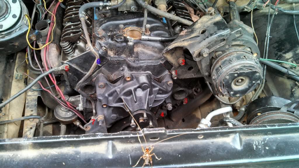

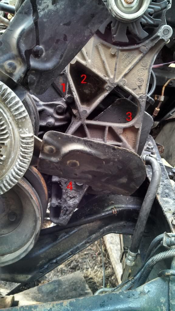

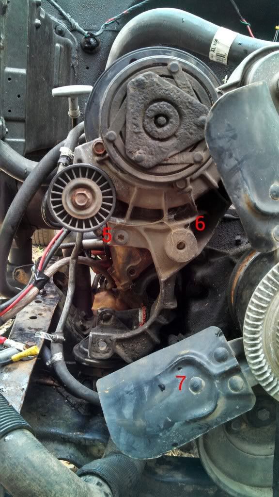

Most likely yes. I'm about to go out and send you one pics
Offline winky
  • Posts: 509
Re: need help with engine accessories
« Reply #11 on: July 27, 2013, 10:36:31 am »
84 engine and 90 model with serpentine. You probably don't have hole 6 (blue one on the 84 pic) sorry the pic is blurry. You could make a bracket to connect the back of the ac to the intake or drill and tsp a hole for that spot. Also if you go serpentine you'll need a 90 model water pump and cooling fan (the belt routing spins them the opposite way)
