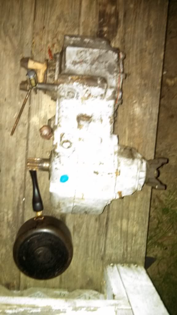

My bad. Meant slip yoke as in drive shaft sliding into t case like a 2wd auto trany. Sm465 trans 205 t case I have a 1410 ford output on my t case. I think... I'll find out for sure. Here t case pic to clear up.

i think/know i have one just laying around but its the stock size for a sm465/205. its what i ran the only reason i took it off is because the way it threads in, threw the back of the yoke on the t-case into the yoke on the drive shaft. wasnt a "bad" design imo but those bolts back out pretty easy and you dont know it till you need it then the other bolt/s will snap off. ill check today and see if i can find it and give you some measurement
