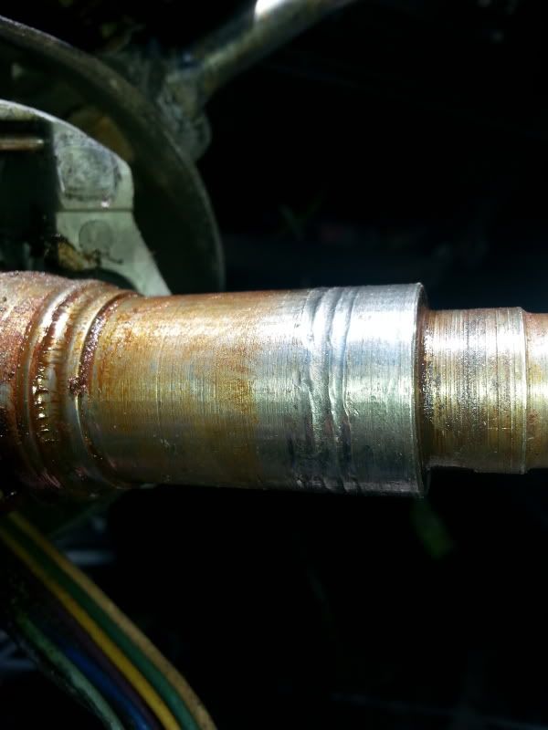

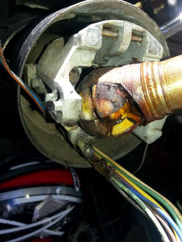

Finally found my tool for pulling the tilt pins out of colums and got mine taken apart in the 77 k5. Found that the upper most bearing was completely Mia except for one lone ball bearing. I was wondering if anyone knew where or if even you could get the upper most bearing for the column. Have tried looking everywhere including the local dealership and nothing came up. Any help would be great as my 93 k1500 needs the same bearing.  just a few pics of  what unfolded.
I also pulled the 4 torx bolts out and put some red on it and fixed the loose tilt problem.
and looks like I need the upper most shaft as it looks like the P/o drove it with a shot bearing for quite some time.

finally got the bearings, lock plate, spring, all that stuff in the mail and got the column back together with a new grant wheel.  So much nicer not having the steering wheel flop all over the place.
