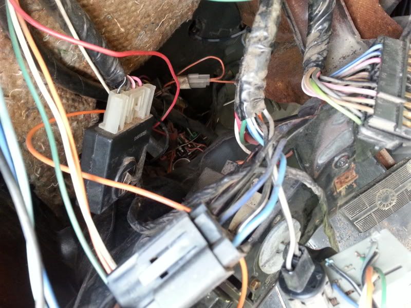

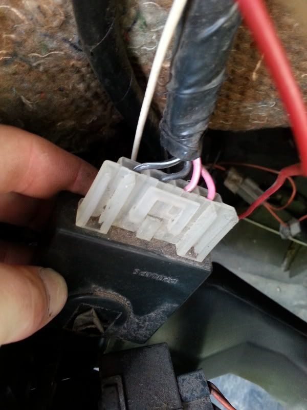

So while working on my 77 k5 blazer found a few small problematic areas that I want to see if anyone has knowledge or advice on. First I was tracing some of the wiring down behind the gauge cluster becasue nothing was working( more on some of that later) but found what looks to be a wiper pulse board? all the wires lead back to the wiper control switch on the dash, however where ever I look nowhere has this part and mine is cracked in half.

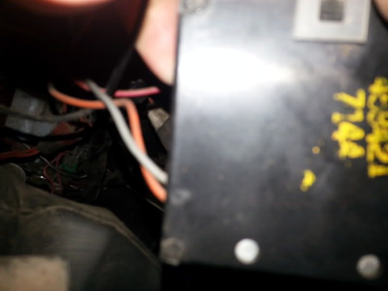

The other one that is stumping me is this one couldn't figure or even begin to figure out what this was supposed to be hooked up to. Has an orange and black wire going into it.

The connector with the orange and black wire is for the clock.
See diagrams here: http://forum.73-87chevytrucks.com/smforum/index.php?topic=11766.0

Are there part numbers on that board?  I don't recognize that..  The wiper control would be in the actual switch...

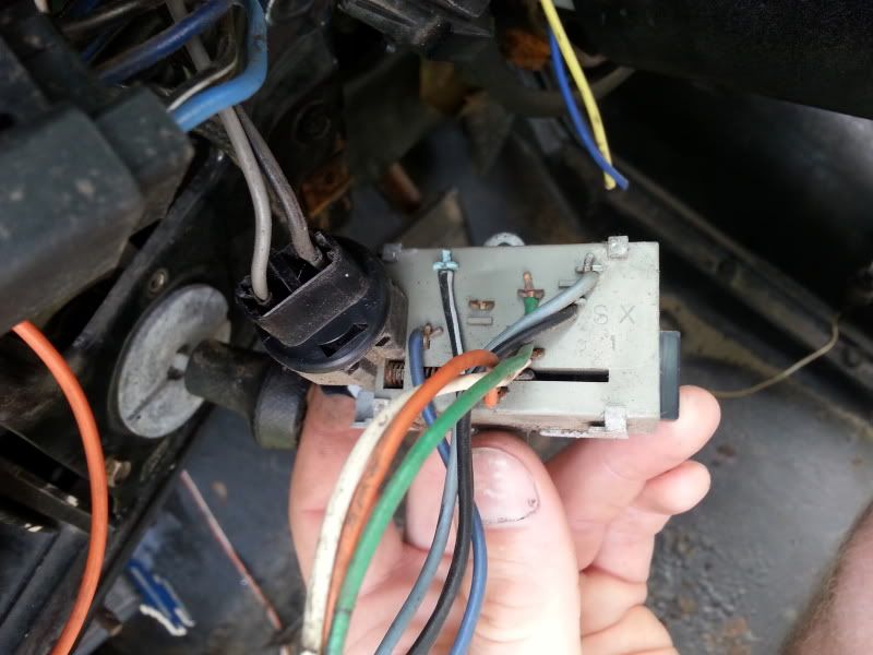

Unfortunately there are no part numbers on the board.  I'll try to get some more pictures of where the wiring goes into and on the switch later today.

The only other component for the wiper is the Relay on the early model, and it is a thin rectangle piece with a wierd L bracket and a power wire tail coming out of it.

Here are some more pics, sorry bout the crappy quality took them on the cell phone.

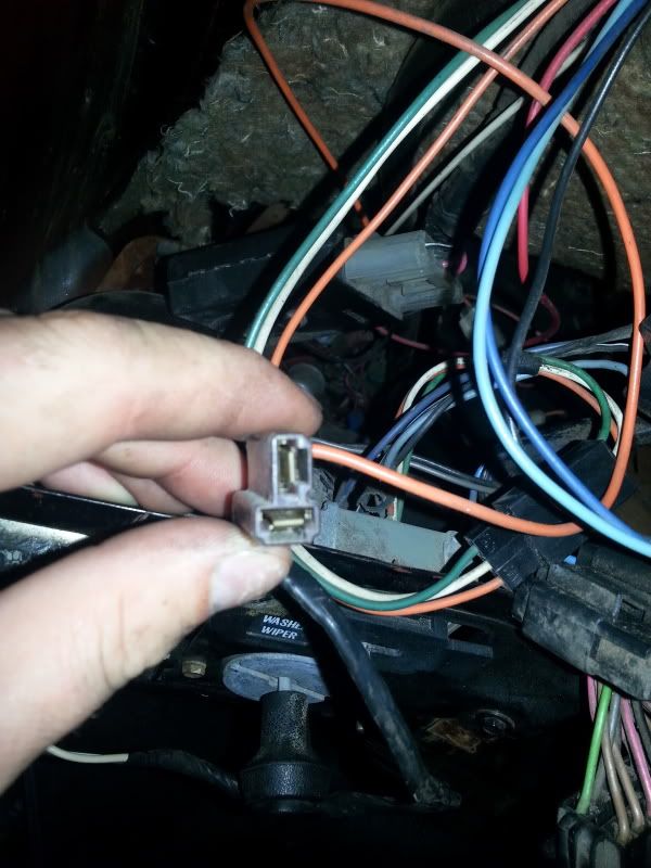

Then it ties into these double connectors

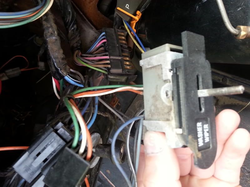

Then seems like 2 wires go into the factory gm harness

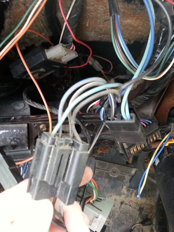

Then its run infront of the factory harness behind the cluster

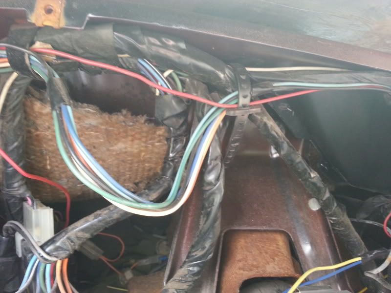

Then on another note still can't figure out what this goes to either.

« Reply #7 on: June 18, 2013, 11:22:07 pm »
Using the diagram here for a guide: http://www.73-87chevytrucks.com/techinfo/wiring_diagrams/77-80_cab_inter.jpg
The Black wire at the lamp  is 97 and it runs to the bulkhead connector
The Grey wire at the lamp is 8F and it runs to a Splice providing grounds tying into Splice 8 here, right side by horn relay:  http://www.73-87chevytrucks.com/techinfo/wiring_diagrams/77-80_instrument_pg2.jpg
The Black 150 on the switch with the stripe appears to go to the SP150 that then goes to the Ground bus here: http://www.73-87chevytrucks.com/techinfo/wiring_diagrams/77-80_instrument_pg1.jpg
The purple 92 goes to the bulkhead harness here:  http://www.73-87chevytrucks.com/techinfo/wiring_diagrams/77-80_instrument_pg1.jpg
The Orange and Yellow should route back to the headlamp switch... I would imagine,  Does this help you get started?

Finally got most of the problems figured out on it but did find the cover for the broken wiper board stuck up under the dash. said it was Lectron Products 459409 part number did a search and couldn't find anything on it really just a few topics for a remote start from them but no other post on the subject.
459409 is the GM part number for a 1977-only wiper delay control module.  The OE part is obsolete, but you might find NOS.  Have your local Chevy/GMC dealer run it on their national parts locator network for any hits.
If the only problem is a broken board, is there any chance you could make a new PC board (Radio Shack has blank boards and etching solution) and transfer the components?  Or, perhaps you could adapt a later model module.
