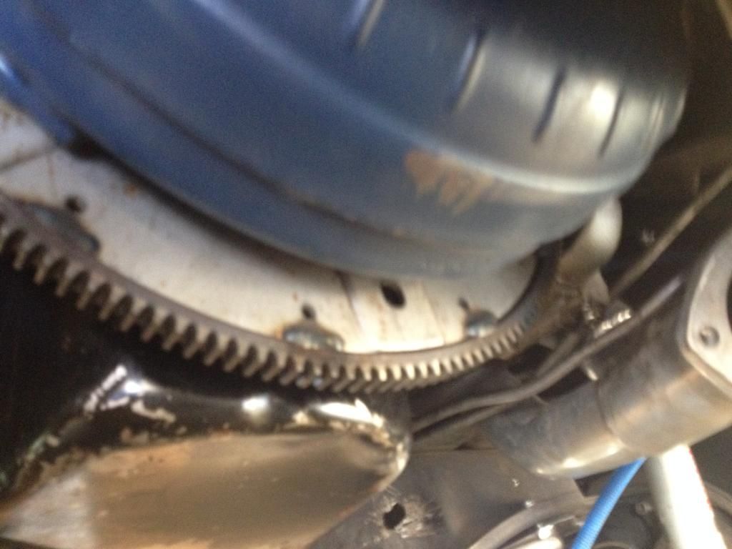

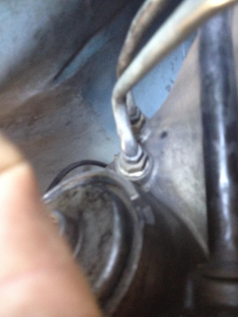

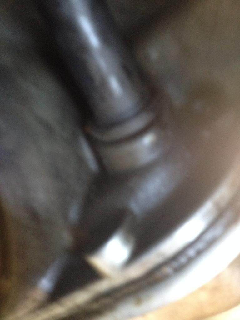

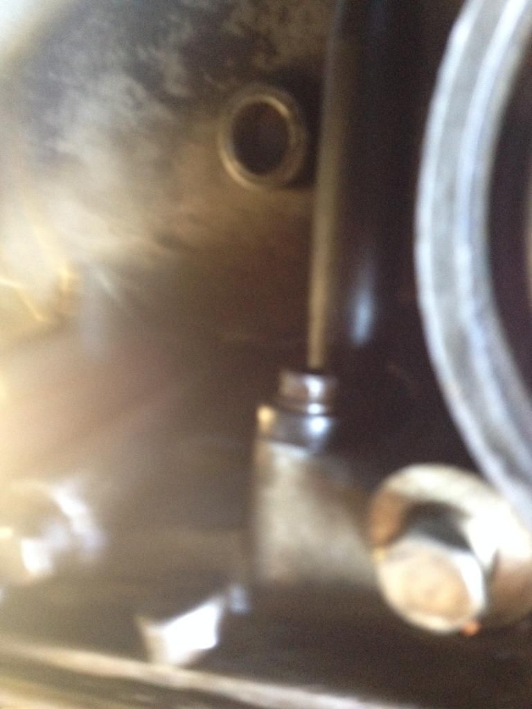

August 22, 2014, 05:53:23 pm »
No signs of a leak running down.
Nothing running down the front of trans where the front seal would be.
A little closer but bad pic.
No connection leaks
Paper label on torque converter no trans fluid on it
The only clue i got is the fluid in the dust cover.
Is it still possible that the front seal is out?
Last Edit: August 22, 2014, 05:57:01 pm by swilliams

Re: 700R4 leak
Reply #24 on:
August 22, 2014, 06:20:24 pm »
Relying on unclear pics - a WAG is pan gasket or front pump o-ring. Although, that is a lot of fluid for either of those, under the circumstances.
Leave the dust cover off and add dye to the trans fluid then use a UV lamp, checking it periodically while it sits stationary over 3-4 days....
