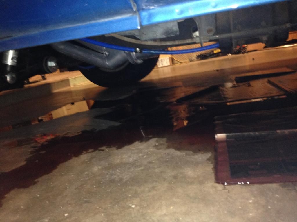

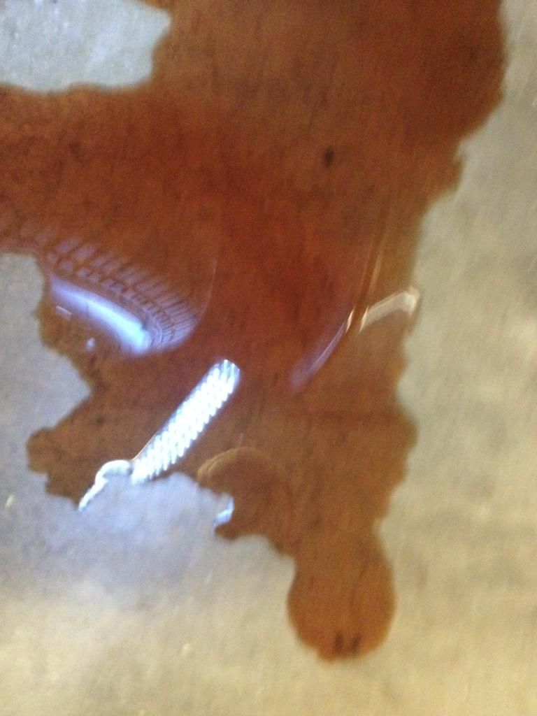

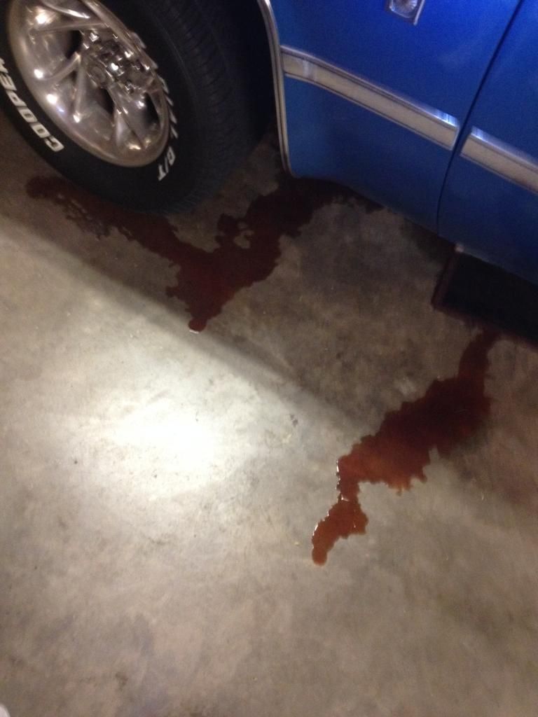

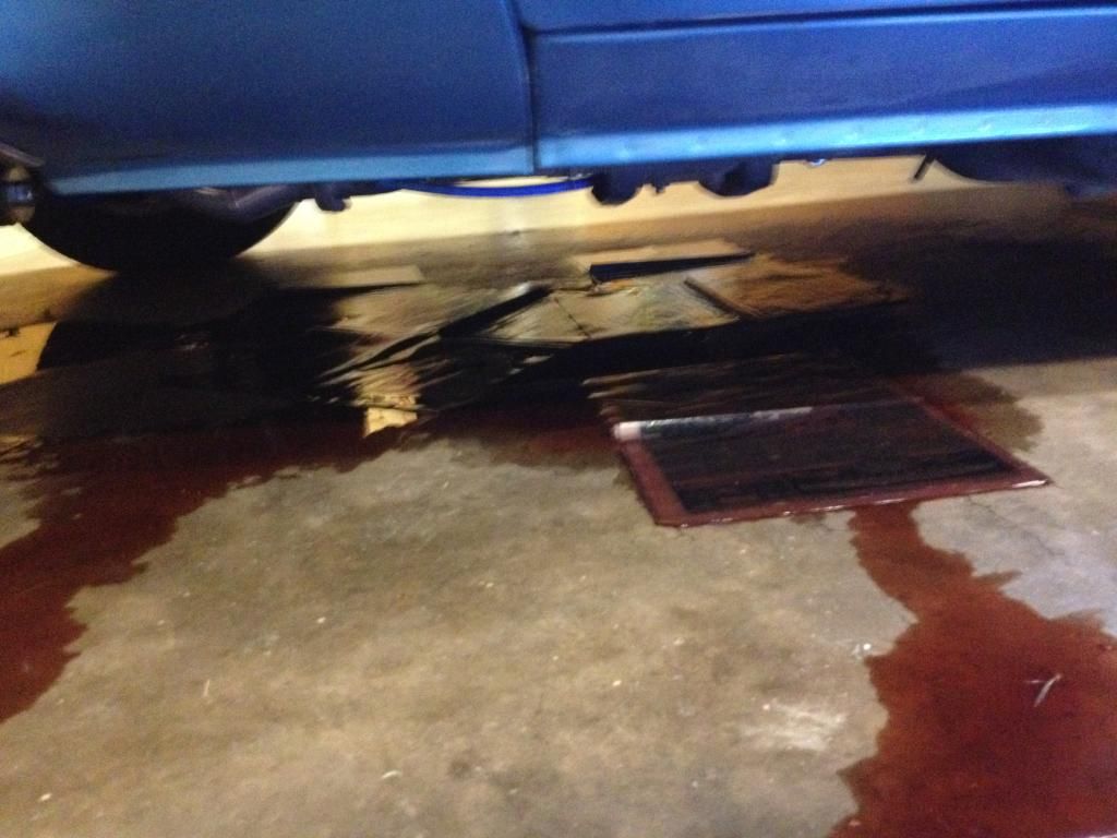

« Reply #8 on: August 19, 2014, 01:55:51 pm »
I have let my truck sit for 7 days. I was able to check on it the first 3 days with no leaks. The next 3 days did not check. Checked it today and found this....
Someone suggested that it might be an overheating issue because before i installed my headers it did not happen but no leaks in first 3 days and...
tranny fluid does not seem to be burned or discolored. Anyone have any ideas

« Reply #9 on: August 19, 2014, 02:05:43 pm »
So it was just sitting for 3 days, not driven and leaked out all that?

« Reply #10 on: August 19, 2014, 02:15:00 pm »
So, you have a static leak.  Use a flashlight and mirror to locate the highest point that is wet with ATF - fluid runs downhill.  Don't start it or drive it, just look for fluid traces around the fill pipe and TV cable seals, servo cover seal, governor cover, speedometer adapter, output shaft seal, front pump & seal, vent tube, shift shaft seal, etc.  That is a lot of fluid for just a few days.  Since the vehicle hasn't been moved, the only thing moving the fluid around is gravity.

« Reply #11 on: August 19, 2014, 02:24:07 pm »
i recently had to change the TV cable. I cleaned around it real good and have not really found any fluid there. As you can see from the trail my garage floor drains back and to the left so for the fluid to get to the front of the tranny i would think it is a front seal. I just have not had the time to remove the exhaust crossover that covers the dust cover to be able to check it. I dont understand why it takes so long to start leaking.
