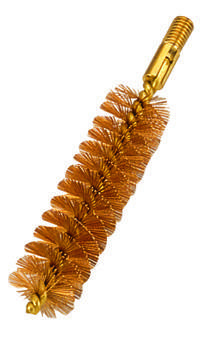

These guys. Put some brake cleaner on em and use a drill and give'er.
https://www.traditionsfirearms.com/data/catalog/products/images/488/400_400/A1278.JPG

Finally got everything right. Vile I thank you for giving me that idea and it helped me out alot. Got my new lifters soaking in oil ready to install. I want to thank everyone for there input and knowledge on this issue
