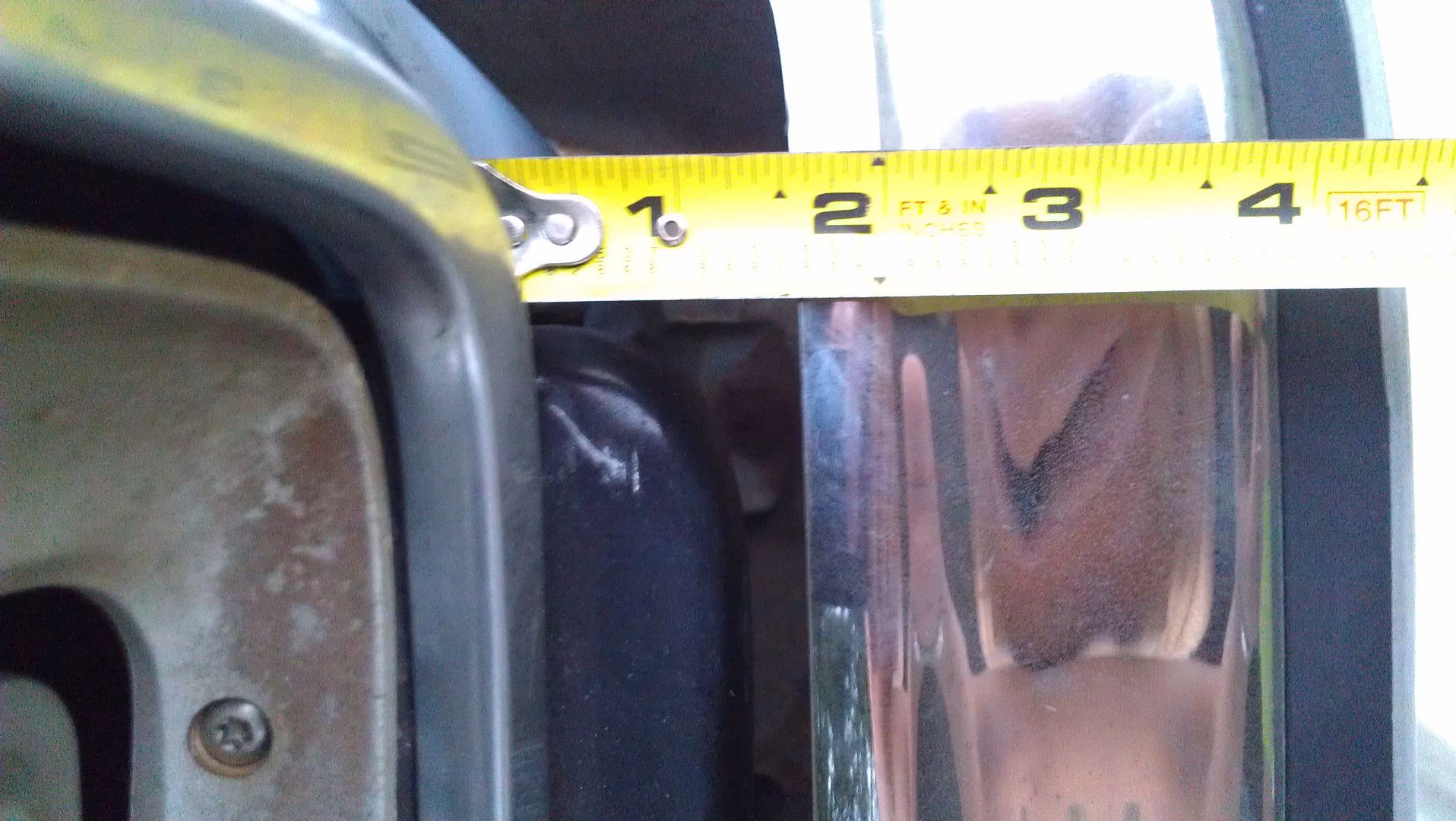

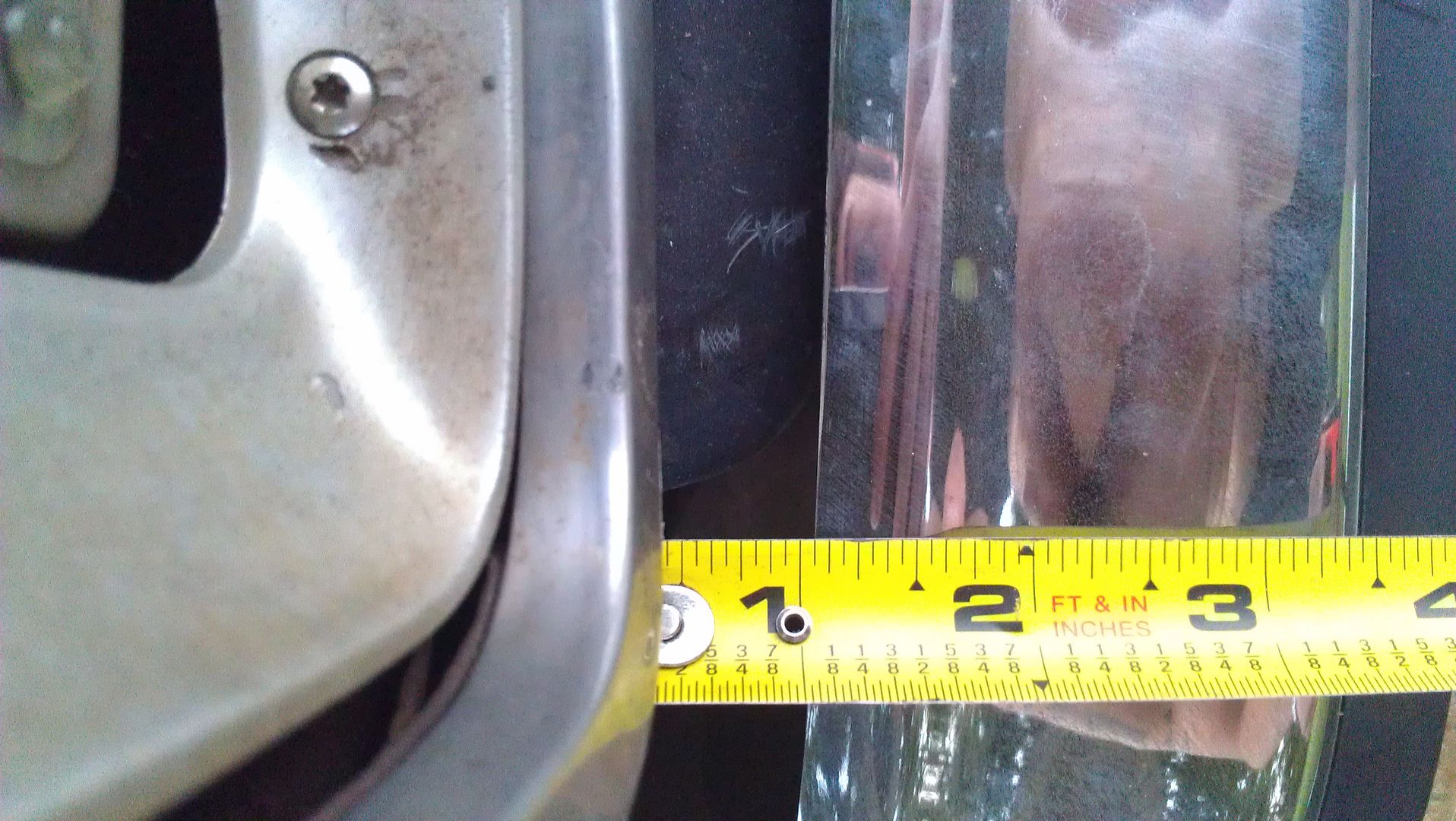

I spent hours today trying to align my front bumper. The Pass. side is pushed in about a half inch compared to the drivers side.
The way I was trying to align it was to remove the bumper but leave the brackets on. Then bend the brackets in and out.
First I took measurements and tried making the brackets exactly the same and even. Put the bumper on and no change.
Then I tried bending the Pass. side out and bending the Drivers side in a little. Put the bumper on and no change.
Then I tried bending the Pass. side out more and bending the Drivers side in all the way as far as it could go. Put the bumper on and no change! >:(
I thought this was how you did it but obviously i'm doing something wrong.
Can someone please explain. Thank you

Post pics

« Reply #4 on: September 04, 2016, 08:00:06 pm »

I don't think there is enough movement in the center mounts, and enough strength in the outer mounts to accomplish what you want, you will need to unbend the bumper- the easiest way is to find a tree and use a come-along to pull on the bumper*a little bit goes a long way.

This is a new bumper so I know the bumpers not bent.
I ended up messing with the 2 inner brackets.
I shoved the drivers side in as far as it went and bolted it down, and pulled the pass. side out as far as it went and bolted it down.
It's pretty even on both sides now and I'm satisfied with it.
