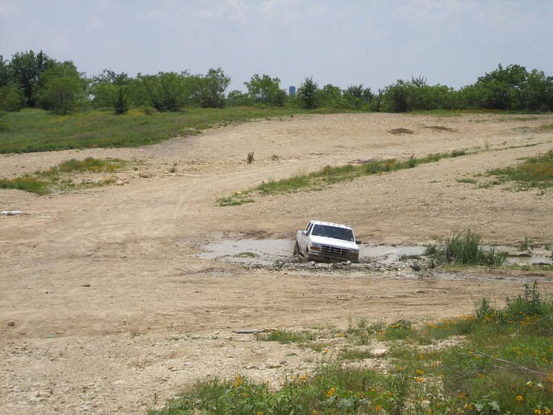

I use my ford for work, i need it lifted to get down the right-of-ways on the pipeline because it can be muddy, the chances of me needing to go places that my truck running on 10" of lift on 37's cant go are none. i still use my truck to tow and long ladder bars will work just fine for me.
and i use it for play...

Haha,   You obvioulsy don't get over to ColoradoK5.com or Pirate4x4.com much do ya?
There are TONS and TONS of guys wheeling (rockcrawling) these rigs.
First off the 88+ IFS trucks SUCK for off road. Secondly, 10" of lift for 37s on one of these??????  I have 37s with only 4" of lift thanks to the Bushwhacker flares. And no need for ladder bars with only 4" lift.
Most guys avoid the lift springs and blocks altogether buy flipping the rear shackle.
That's not wheeling, that is a waterhole on the way to the trail.

no i really dont go over on those sites, that is some nice flex but doesnt the aid of the fliped shackle help? that little water hole is just about the only thing i can take my truck in, my trucks to long to take on little trails, if i had a "trail rig" them yea that little water hole would silly. i built my truck for work. back on topic, ladder bars help in axle wrap...no matter how much lift you have.
