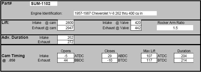

Also, what timing do you think my cam should be at? Summit won't tell me. :( I was thinking around 12 advanced or so. But I'm not sure, I'll let you pro's decide.
I have to roll with this cam until I get my lower end reworked. Then I can get my lunati in there. ;)

That's a pretty mild cam. Set your total timing to about 36° and see how it does.
