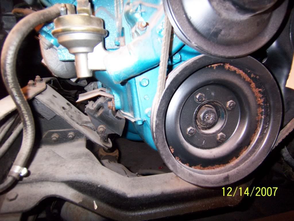

Hdloner, I pretty much agree with the other guys, however the 307 Olds (not Buick, it may have been in a Buick,but it's an Olds ???) for the most part, is a good longevity engine, not the best choice for a truck necessarily though. Since you asked, the basics are this. You will need Olds-based diesel mounts (mid-late '70's) or make adapters like I did (a plate across the three bosses on the block w/studs) or move the lower half on the frame plate (I did my 4x4 this way). A transmission adapter (Trans-Dapt, makes two, the 3/8" thick one is the one you want), the battery should be moved to the Left side. The accessories will interchange, you will need to lengthen a few wires,hoses,ect. The exhaust will work out fairly well, as well as the fan shroud,ect. also. It is a do-able weekend swap if well prepared, but I don't think I'd bother, now a 350-455 :) :)  Lorne
