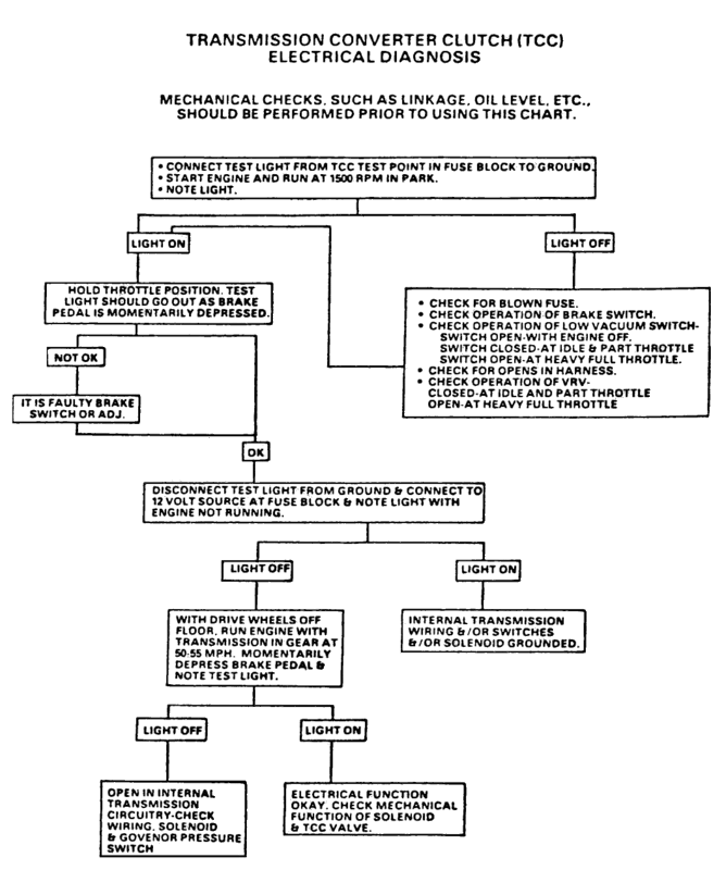

« Reply #6 on: March 21, 2008, 04:48:47 pm »
Your lock up converter isn't going to save you that much fuel economy! You'll probably notice a 200rpm difference.
Now check the basics instead of changing parts. So you have a non computer controlled lockup is what I was trying to determine with you before.
direct link
http://i6.photobucket.com/albums/y228/Sabaka454/tcc.gif

« Reply #7 on: March 25, 2008, 07:24:41 pm »
There's a vacuum switch on the firewall above the distributor
see if the hose is connected (this switch open when the vacuum drops, unlocking the converter)
this circuit also feeds through the brake light switch (when pedal is depressed it unlocks the converter)
