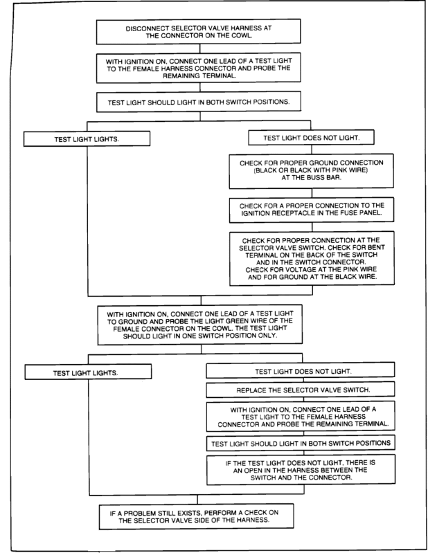

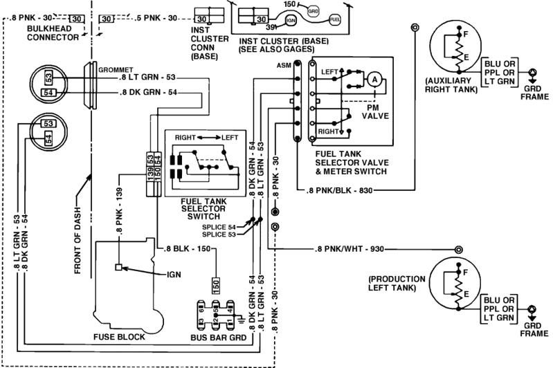

Hello from a newbie! Have an '83 Silverado 3/4 ton 4x4 Camper Special owned since new. Auxillary tank has quit working. Had to depress switch a few times to make tank switch just before it quit working altogether. Have replaced switch with a brand new one. have replaced switching valve with a new one (an ugly, ugly job). Still not working.
Is there an inline fuse or fuseable link somewhere? Although this does not square with it working intermittently just before it quit altogether. Looks like I have to pull dash pad to follow wires back from swith to instrument panel looking for broken wire - whatever.
Just wondering if anyone has experience or can tell how to track down failure.

Welcome to the site! Which tank isn't working? I posted the diagnostic flowchart on this a while back...lemme see if I can find it...
Here it is
Chris maybe you can sticky this page
direct link... the image restriction resizes it so maybe the direct link will help you read it better.
http://i6.photobucket.com/albums/y228/Sabaka454/fuelselector.gif

Diagram
Direct link
http://i6.photobucket.com/albums/y228/Sabaka454/diagram.gif
Direct link
http://i6.photobucket.com/albums/y228/Sabaka454/fuel2.gif
