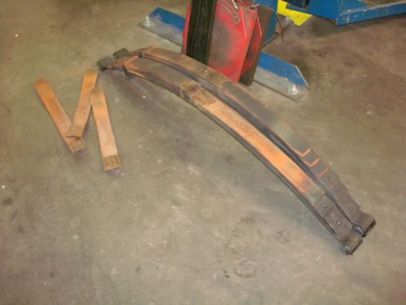

Here's an 8 leaf that had one bad leaf and I decided to run them as a 7 leaf until I knew what I was going to do for rear suspension and then this happened as soon as I womped on it
