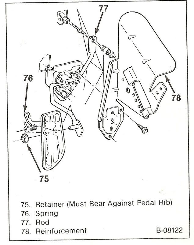

Here is a picture of how it goes together:
Hope this helps
Jeff

That picture is perfect.
I can't figure out how to get #75 (in the above picture) off.

I knew it was that funny little push cap you were fighting with.   ;D
Those caps are typically a one-time use type thing, and they always seem to break when taken off.  The "cap" is simply held onto the shaft by the tension from the little tangs in the center.  If you're careful you might be able to get it to slide off the end by prying it away with a small screwdriver or needlenose pliers etc..  A combo of using both seems to work best for me.  Just watch out that it doesn't go flying away into the nether-regions of the floorboard when it finally comes free!
