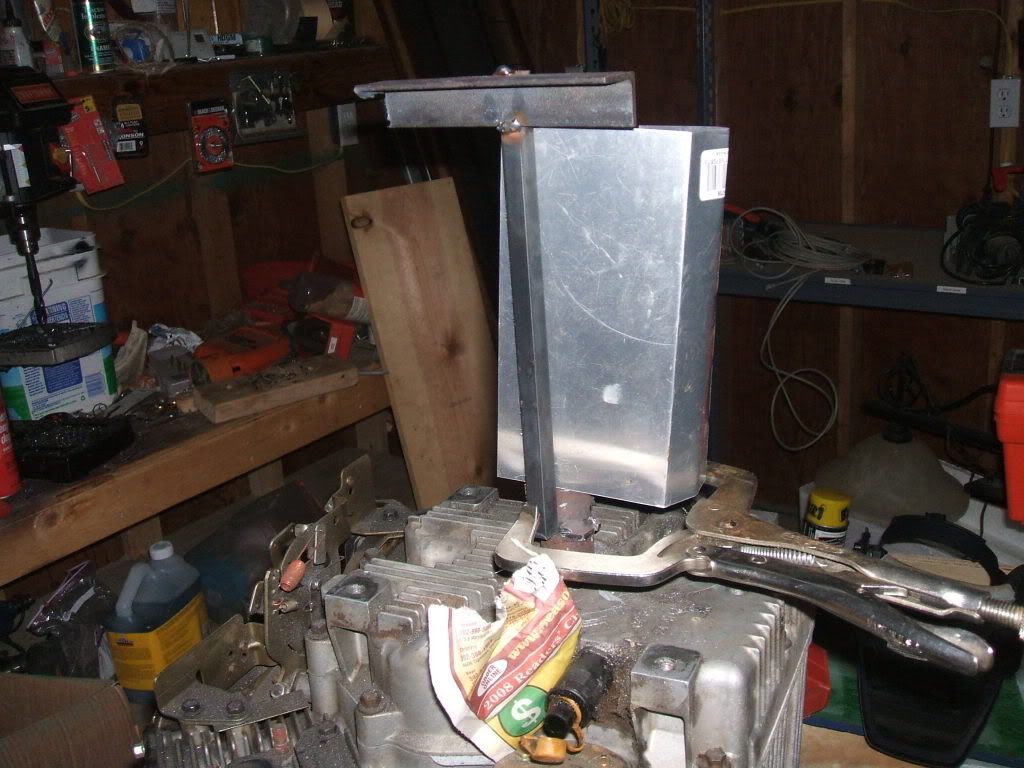

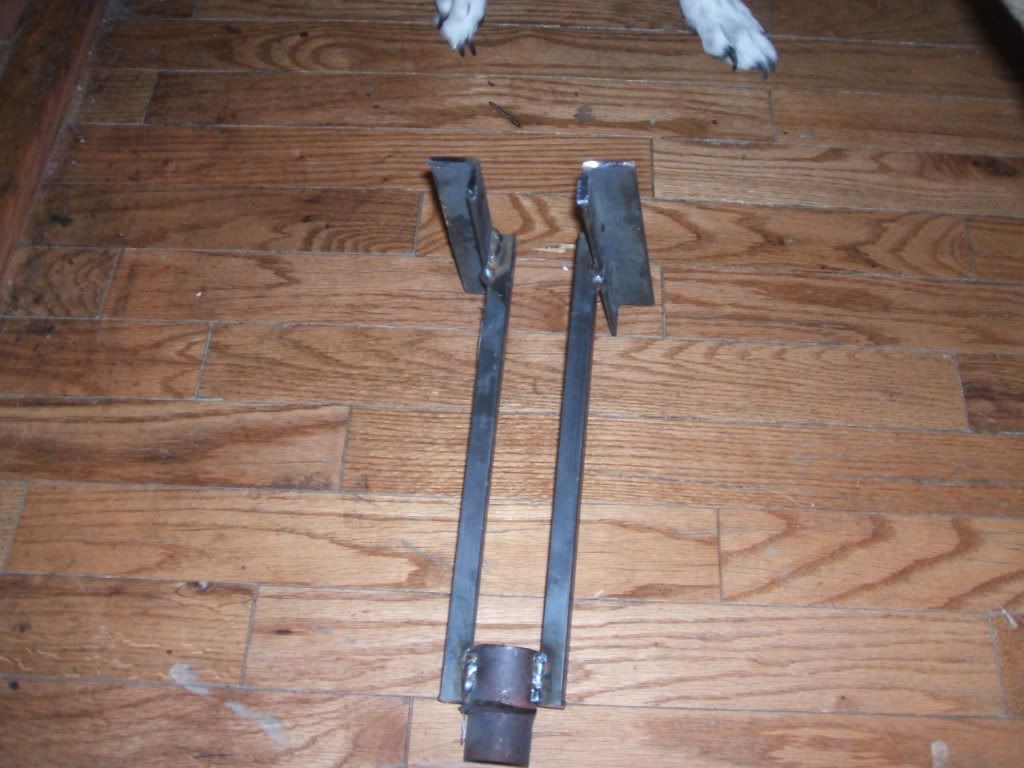

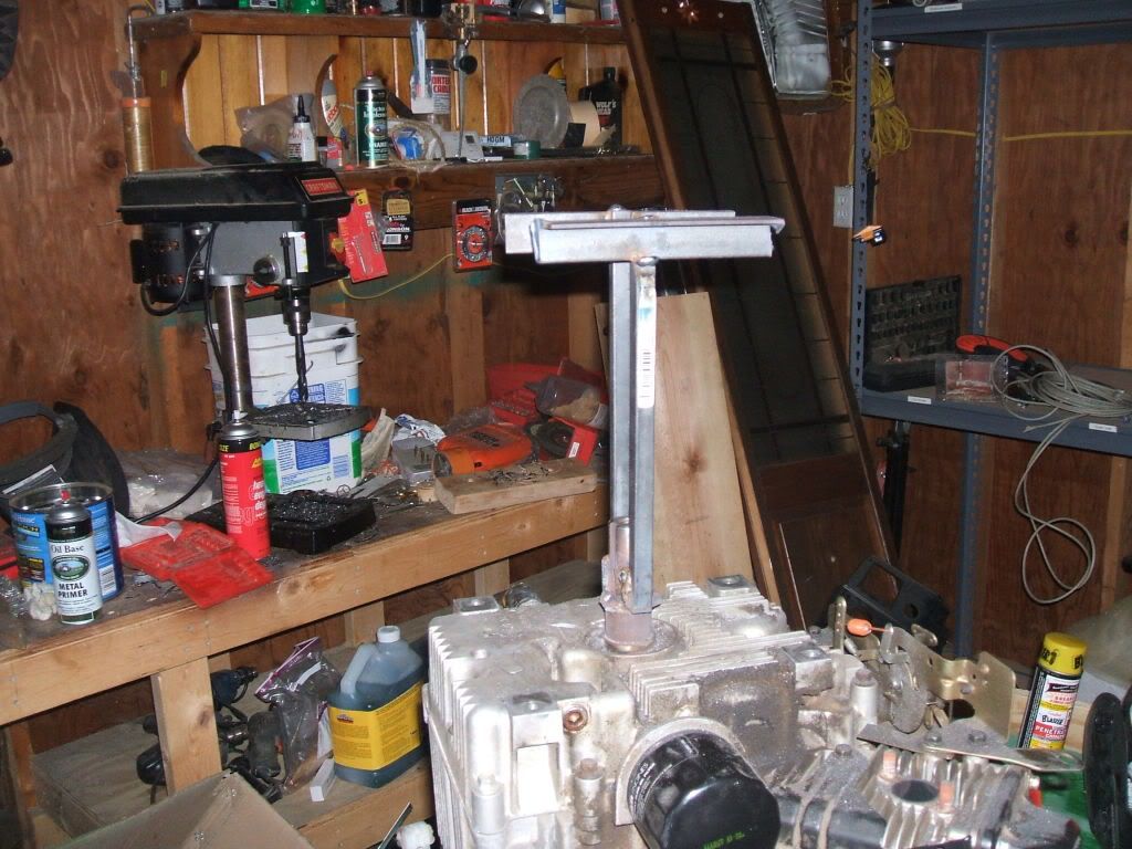

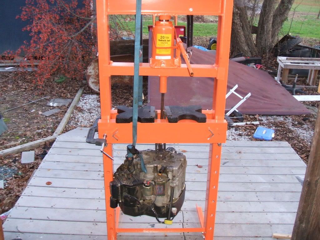

I earned my official red neck title today words can not describe how I did it I will post pics once I get some batteries but in short I took some 1/2 bar stock welded some angle iron to it then welded that to what was left of the pulley . Once I figured (again red neck title) out how to get it in the press with my contraption it came off like it wasnt pressed there . Still can not believe how tight it was on there it is crazy hopefully the new one goes on easier :) . Next question is easier whats a good anti seize to but on the crank?

Lining it up to be sure it is straight and level so it wouldnt go crooked once in the press and some metal to protect the crank
all welded up
In the press ratchet strap was too short had to find a longer one just for saftey
Finally off.
