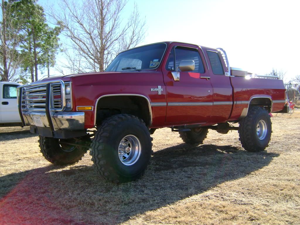

« Reply #62 on: January 03, 2009, 08:57:28 pm »
Capt, heres a better pic if you want to use one of them, let me know. I performaed a Krylon overhaul on the wheels. It looks ok till the new ones get in.

Ive had something bothering me about my red truck that I couldnt put my finger on for sure. I figured it out today. The left rear wheel fits perfectly in the middle of the wheel well. The right side is a good1"-1 1/2" forward. I checked the blocks positioing several times and a friend came over so we took some measurements. My axle that I just installed is bent forward on the right side. ??? :'( The good new is I scored another axle, plus Im trading my 38's to my father in law? (wifes sisters father in law) for the two drive shafts. He is going to put it in his shop and have the driveshafts built accordingly. My brother in law is machining me a couple of spacers to drop the transfercase a little, and I traded for a nice, red hood. The one on it has a few little dents. All in all, it turned out to be a good day, except I have to replace the rearend again, but with my tractor, it will only take about2 hours. I have never seen an axle bend this way, I guess some time n the past the donor was rearended or slid into a curb. Oh well, it will be right soon enough.
