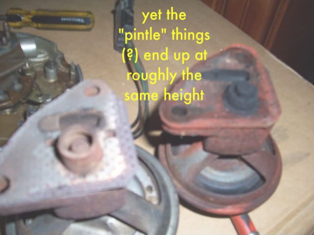

Well now you can write a song to the tune of your chugging engine. Eliminate the EGR as a possible cause. If it's stuck open it will act like a horrible vacuum leak, the engine won't idle and if it does it will idle poorly. Your vacuum gauge will read crazy. It's an easy enough thing to eliminate to determine if it's stuck open.

i tried the EGR thing without hooking up the vacuum hose and no-real improvement---besides the less propensity to stall out.  But the thing about EGR situation is, and i didn't really catch this was:
i noticed that the "tube" mechanisms of both EGR valves are different heights.
But the "pintle" mechanism/valves are roughly at the same height in both instances, therefore both EGR are sealing ok.
In addition, i could not blow air thru either one of them until i pushed up on the diaphrams, so therefore i'm ASSuming both valves are good.  As another note, i would not recommend blowing or sucking on the valves (unless you have a rubber tube connected to them) as they taste awful.
