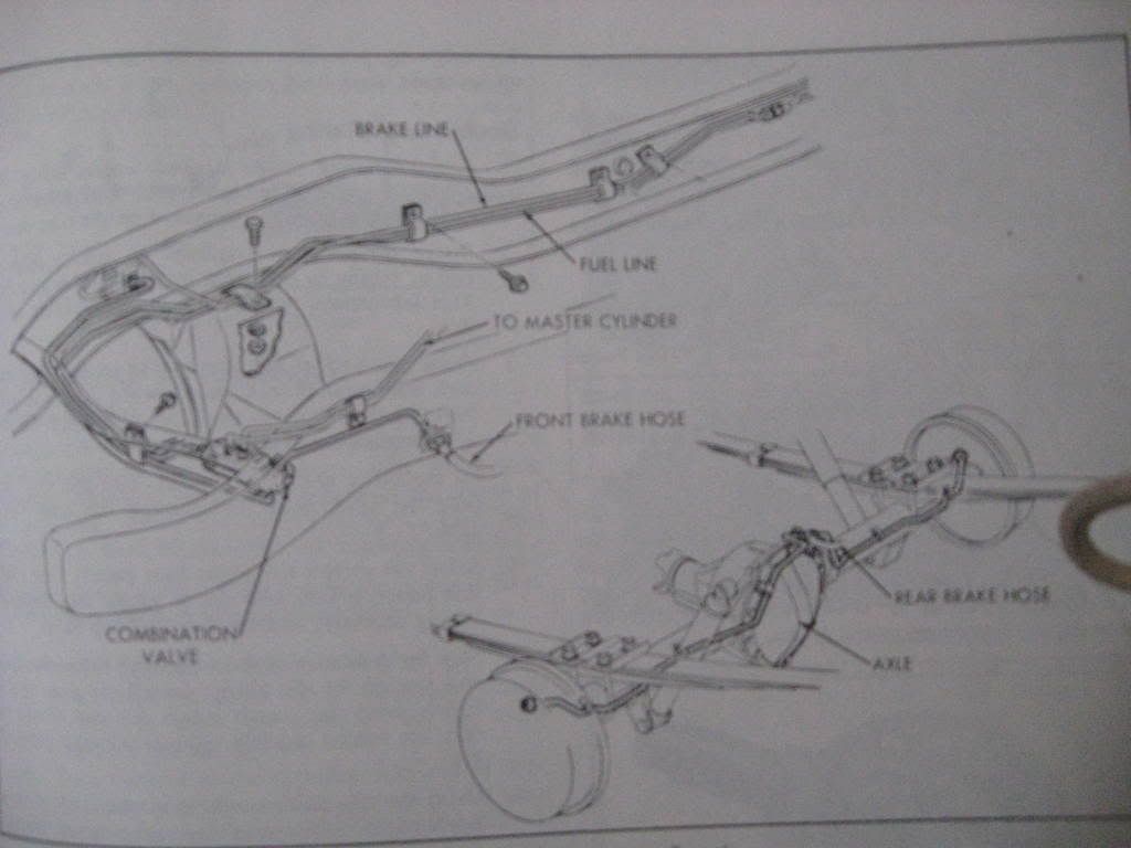

I know what your thinking.. He didnt take pics. I did, but not enough. Especially around the proportioning valve and the motor mount plates. I want to make sure I don't interfere with my headers and shock mounts etc. I'm running the fuel and brake lines together because I have a fuel cell setup. I tried using the pics from 73-87.com but his truck is a 2wd and is a little different.

might not be the best, but my scanner doesn't work, from a gm service manual (1973)
you can zoom in this:
http://s301.photobucket.com/albums/nn77/prfakaharry/1973%20gmc%202500/

Thank you very much. Perfect angle too.
