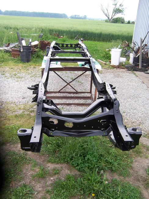

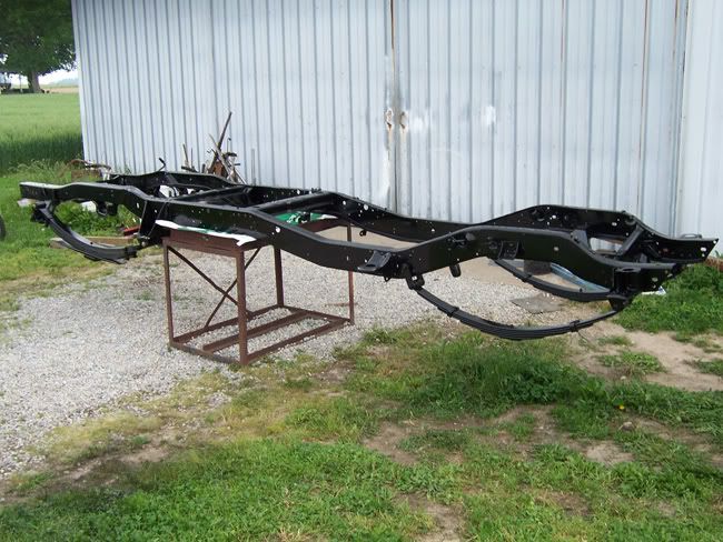

ha, well, its been about 2 months or so now but some progress is coming and I'm happy with it. Finished painting the frame 2 days ago after about a month worth of prep to get down to bare metal and after chipping off all the rust scale. I acid washed it with dx579( i believe) and then washed that off before i shot it with 2 thick coats of tractor gloss black. I'm happy with the outcome. I Carefully put on leaf packs yesterday. Finally feels like I'm actually getting somewhere on this project. Going to start on the axles tonight so hopefully it will be back on its wheels in a week or so.
Here's some pictures, I'll post more next week of it back on its feet. Thanks for looking, Andy

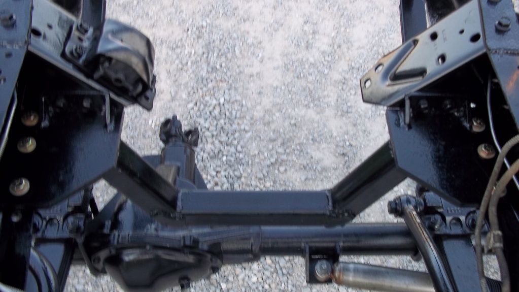

Built me a new crossmember to clear the Cummins oil pan

Im in the process of body work and prepping the truck for my paint guy. I'm still going with the 73-80 doghouse. Going to complete my chassis while my body is gone. Still have to fasten brakelines, put in new rubber motor mounts, install my 205 transfer case and my driveshafts. This will be completed sometime in the spring.

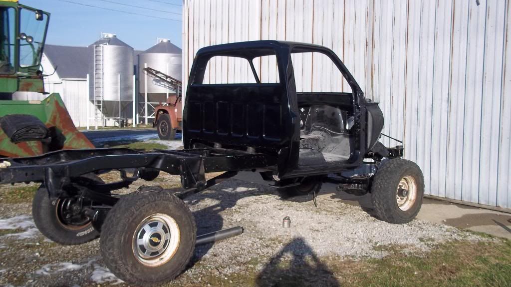

Took my cab and dog house in for paint today. Earlier this month I hacked up my core support for my intercooler and fabbed up mounts. Going to use a Chevy 4 core radiator since the Dodge radiator wouldn't fit the way I designed the truck.
A 89-93 downpipe fit dang near perfect. Running 4" exhaust(5" wont fit past transfer case) to a 6" stack. Im finishing up the little things on the drivetrain before I get my body back.

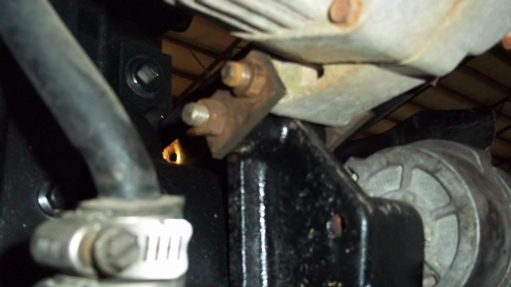

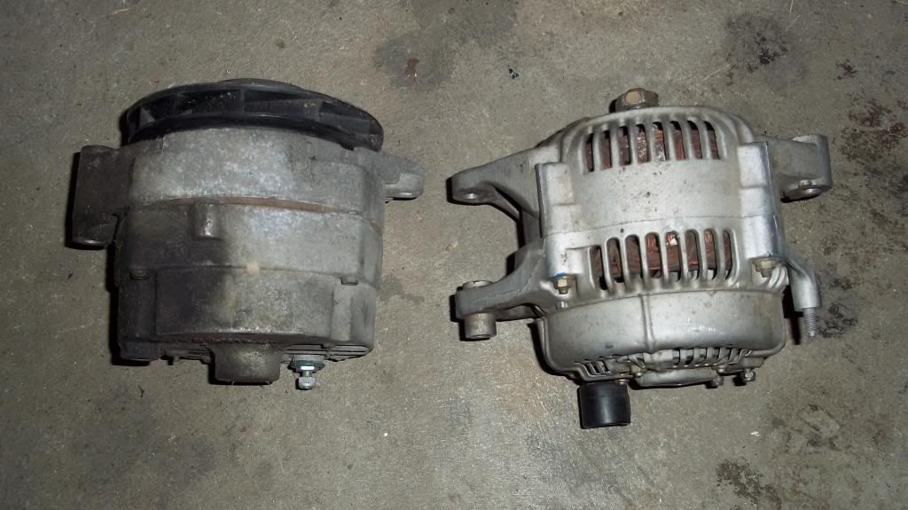

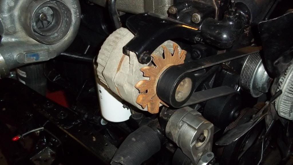

Managed to bolt on the stock chevy alternator to the cummins. Nice to just use all Chevy electrical components rather than having to worry about wiring up the Dodge. Alot easier than I expected. Basically just drilled out the threads on upper mount on the alternator and put in the stock location and used some flat stock for the lower mount. I put the dodge pulley on the chevy alternator and with little bit of shimming, i got the the belt to run true.
Chevy on the left, Dodge on the right.
Lower mount
Upper mount
Looks like everything will work in theory. Just have to see if works once I get the thing running.

Nice that you used the Chevy alternator.  What are you going to do about the AC compressor?

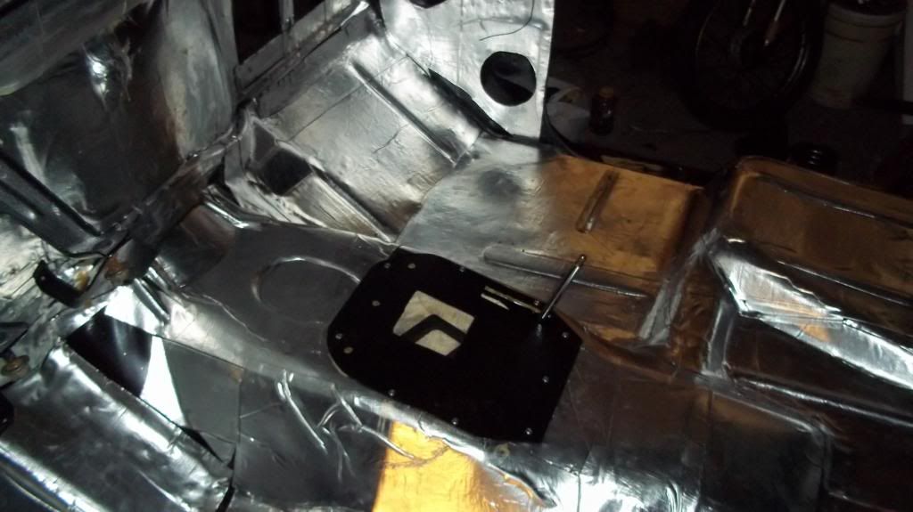

I've been working on the little things and knocking them out. I sound deadened the firewall and floor of the truck so far. Had to weld me up a crazy transfer case shifter bracket and lever but it worked out nice. Made a plate for the transmission hump, sealed it and screwed it down.
 I fabbed up my clutch master cylinder firewall support rods so they would fit the F-350 master cylinder and reworked my clutch pedal so It would work with it. Had to weld an extension to the clutch pedal bump stop so my master cylinder wouldn't take the complete force of my foot stomping it. Also welded and tab to the pedal for the rod to attach. Took a few tries to get it right where I wanted it but finally got it.
Also, I installed my jute padding and a vinyl floor mat. I don't recommend working with vinyl in cold temperatures because its a complete pain to work with. It turned out decent though. Installed my heater box and sealed it up. Welded me up a shifter and installed my shifter boots which I think turned out nicely. And with a little modification to it, I installed a later model Tahoe overhead console. There are some voids with the curvature of the roof but they will all be filled in once the headliner is installed.  Kinda started on the wiring tonight but its kinda overwhelming. Going to really get into that tomorrow night and hopefully I can knock a lot of it out.
