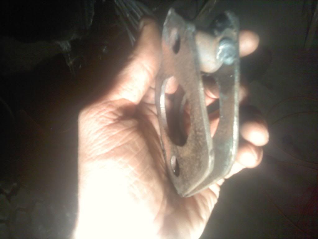

Small update. Again, knocking out a lot of the little things that aren't very interesting. I hooked up my clutch hydraulics and found the clutch to be WAY to stiff. Lots of firewall flex even with the support rods/brackets that run from the pedal assembly. Did some research and found my problem. I installed my master cylinder(from a 1997 F-350) and bolted it directly to the firewall and welded a bracket to the pedal lower than the stock clutch rod pivot point. I wasnt getting enough leverage so I made a wedge that I bolted to the firewall that is exactly 15* which allowed me to use the stock pivot point on the pedal(had to make an extended clutch rod of course). Works perfectly now and feels like a stock clutch with little to no firewall flex.
picture of the wedge

Great progress:) I am suprised you had firewall flex, I used that same master cylinder, but I cut the rod and lengthened it by putting threads on both sides of the rod and adding threaded end to dial in the length , I also re drilled the clutch peddle so it wouldn't bind up.
None the less , your truck is looking great!!!

Cubicdollars: I was very surprised too. I tried to copy your set up exactly and for whatever reason the pedal was very stiff and the firewall had some flex.  Im not sure what I did different from you but the wedge I made fixed my issue. Regardless, I couldnt have figured it out without your advice!
