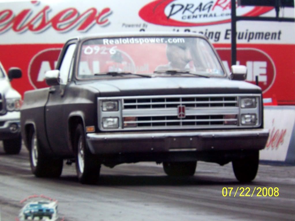

Very Nice! One more concern at this point. The rear bars done like that are not NHRA/IHRA legal if you plan to "test out your handywork" at a sanctioned track. I'm not saying you won't get away with it, it's just don't be supprised if...kinda thing. A guy near me has run a S-10 with a complete hoop/door bars inside the cab & nothing else for several years in the 10's with no problem. In the rule book is some areas on "truck roll bars" (for the pro stocks mainly) it goes on to say "no rear bars required, da da da, but must pass 25.5 spec" (these vehicles look worse than a jungle gym) bars everywhere, across the floor, rocker rails, funny car cage, ect. When I first saw this section in the rule book, I was planning to do bars just like yours...until I got some help with the details. Not picking on you...just would hate to see you go to the trouble & be disappointed later. Keep up the good work! I would love to get that much done in so little time. Lorne

The bars going out through the back will likely be the main reason I won't be going much faster, I guess the wife will be the judge of that. If a guy puts a complete cage in the cab: main hoop, A pillar bars, windshield bar, door bars & bars like yours...that sure would seem safer/stronger than just a 6 point (main hoop, door bars & correct rear bars) that is legal down to 10.00 with a stock floor & firewall. That was why when the "truck section" was found...I thought we were on to something, oh well. You will "get away with it" a pass or Two I'm sure..especially the last day of the year ;) Nice work & have fun! Lorne

You got any bigger pics of your avatar? Looks pretty cool from what I can tell...seeing it a smaller pic. I'm newer around here so forgive me for asking but....what motor and all that are you running? What kind of track times are you seeing?

Jason, It's really a pretty mild 455 Olds (stock short block w/hyd. flat tappet cam, some workbench port work, Q-jet, ect.) a 4l60 tranny w/a used S-10 converter & 9" rear w/3.50 gears. LOTS more to wring out of it, I'm sure. I built it for my wife as her first bracket racer/street toy for low dollars. She's gone high 11's @111 mph. She's all giddy...the race schedule came in the mail yesterday. Lorne

Thanks for the info! That’s a really cool picture.  That’s awesome that your wife is down with racing and such. What size rims and tire you running up front in that thing?

Jason, The fronts are 205/75-15's on 4" or 4 1/2" wheels. Yea, having the wife WANTING to go racing & spend money on a hobby vehicle is a real benefit. I bought her new Et Street radials for Christmas ;D  Back in the summer I had to tell her "Not this week" a few times, she was killing me in gas money...It took $100 round trip to the track. Her solution...Go on Saturday, stay over night & race both days, come home on Sunday. "Hey, it's half the cost of going back & forth"  ??? I guess I'll deal with it  ;) Lorne
