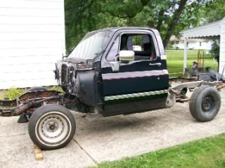

This is the truck I bought almost a year ago. I haven't worked on it much due to the cold winter ( I live right between Erie Pa, and Buffalo NY....BRRRRRR)  It was origionally from S. Carolina (Greenville?) Here is my progress so far.
Just drove her home 3/21/08

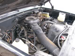

4.3 V6...Not gonna cut it.
C-ya  (my old '91 burb in the background)
Doing most of the work in my tiny garage.

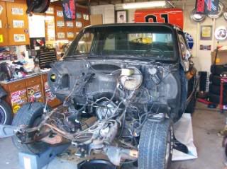

Test fitting my 500" Cadillac engine. It was in one of my '75 coupe devilles. It will be a stock rebuild with an Erson cam,Edelbrock intake, and some valvetrain mods. Still undecided on the carb, most likely going with an 870 street avenger.
The bolt-in was quite simple. These are 350 brackets trimmed and flipped (driver's side on passenger side etc.) with Eldorado mounts attached to them. I used and adaptor plate and the trucks 400 trans.
The only issues are the brake booster hitting the valve cover and the pinchweld on the lower firewall needs to be trimmed slightly to make room for the driver's side cylinder head and exhaust manifold. No problem.
Had some neighbors come over to help me remove the box

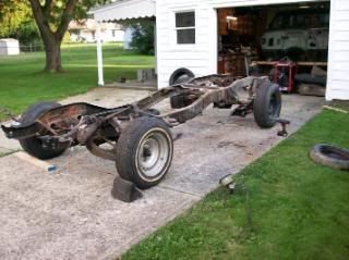

Had to remove the cab myself.....not fun. I put it up on sawhorses and rolled the chassis out from under it.

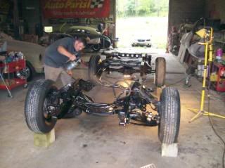

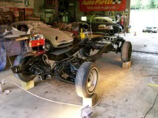

Took it to my buddy's garage and cleaned and painted the chassis. His garage is huge....lucky.
Got it back home.
That's all I have for now. I'll get back at it when it warms up out here.
