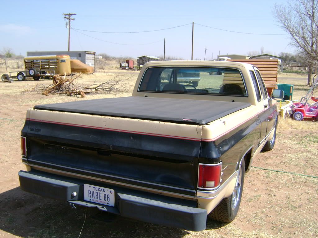

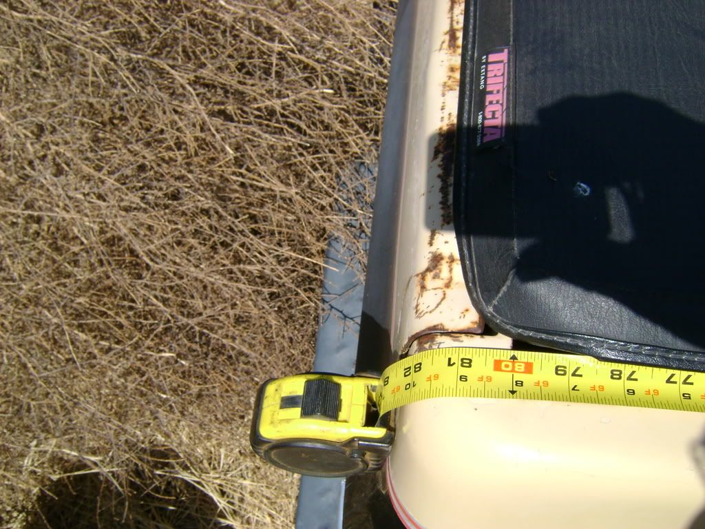

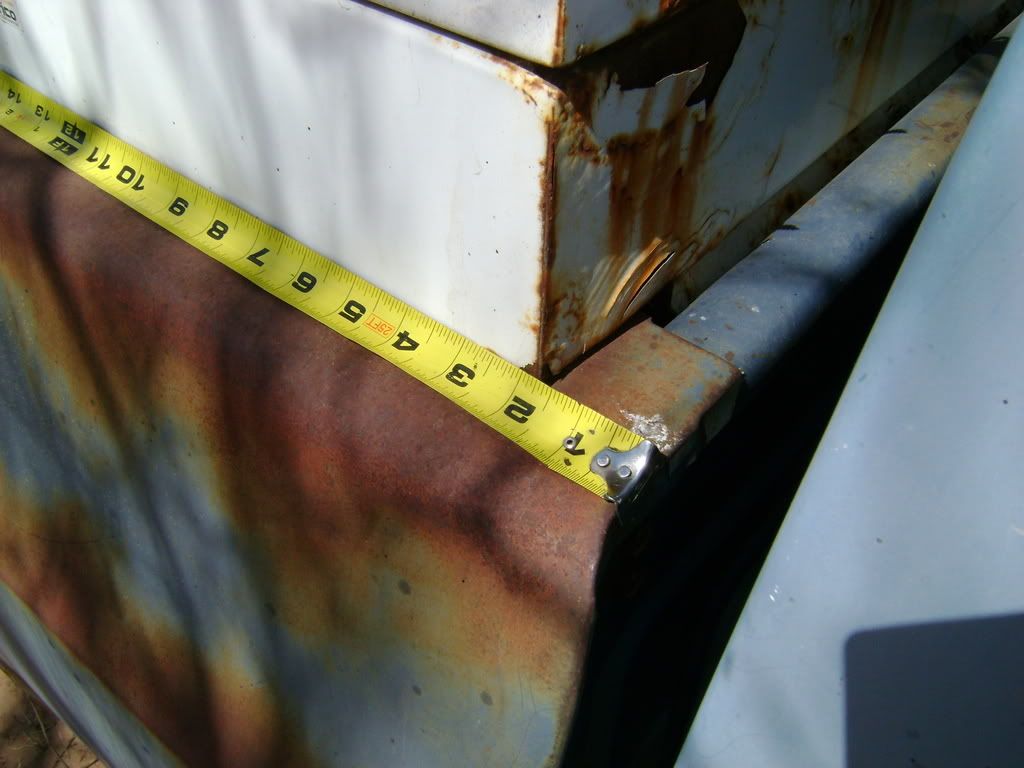

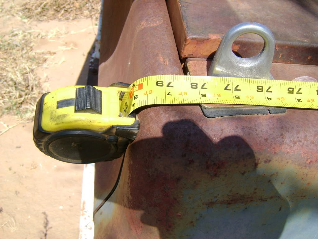

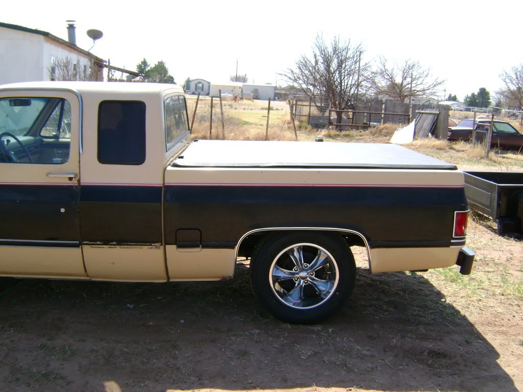

Ok guys, sorry for the delay. Heres some pictures and some measurements. Now take into consideration that my be is baout 2 inches longer than a standard shortbed
This is how I measured the bed on my ex cab
Heres the measuements on my swb

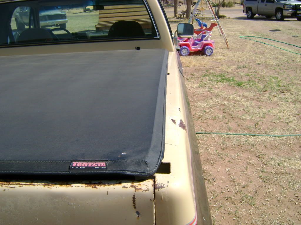

The bedcover itself is 81" long, but may be different depending on the cover. This is an Extang Trifecta for an 04 swb. I think you could slide it forward 1/2 inch and have a little more over the thailgate and look ok on a standard swb. I cant test fit it on my swb due to toolboxes. Hope this helps
Re: Newer truck tonneau for 73 - 87?
« Reply #12 on: March 06, 2009, 01:03:46 pm »
on second thoughts, you will have to slide it forward a bit more. If you look at how it lines up on the tan truck, if the corner of the cover was at the corner of the bed in front, it may just clear in the rear. Once the bed rails are filled and smoothed, I think it will look ok on this truck. Still indecided
