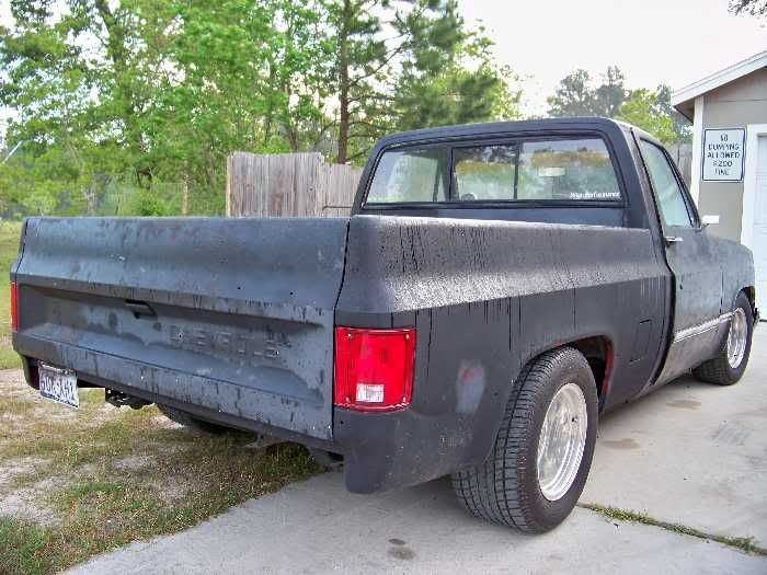

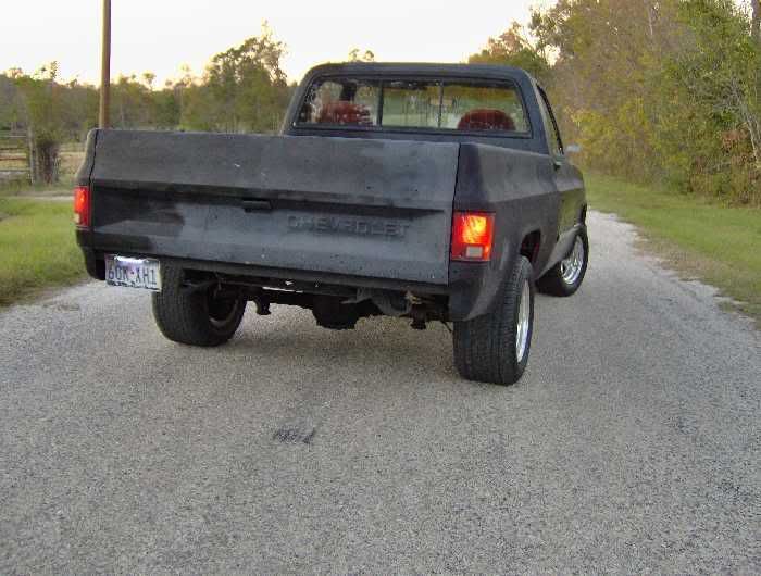

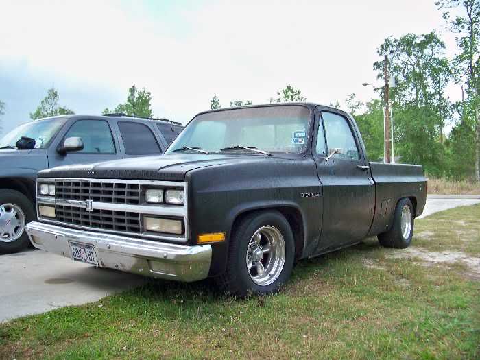

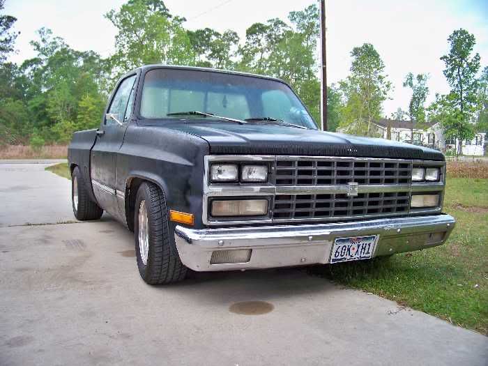

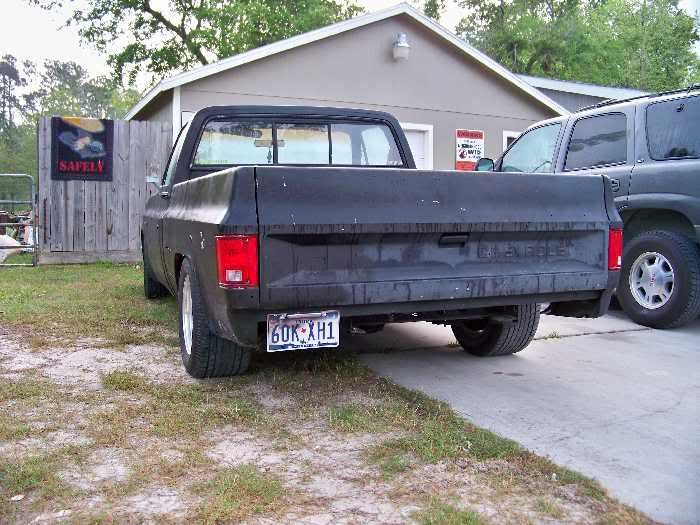

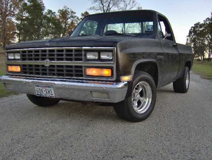

Finally got a few pics shot this morning. There was a dew on the truck, and I didn't really have a chance to wash the truck before pics...but oh well.
Before:
AND finally after:
Brian
'82 Chevy Silverado AKA Project "Cheby"

« Reply #6 on: April 05, 2009, 09:54:15 pm »
I love the attitude look. Do you have headers and if so are they close to the ground?
I've got some new long tube headers....but I just haven't installed them yet. Hopefully in a month or so I'll have them on.....because I'll have the entire exhaust redone with 3" pipe with dumps....and probably 1 chamber Flowmasters. I've had the truck on a rack already....and there should be plenty of clearance for the headers.
I actually had a '70 Chevy truck before that was lower in the front and I ran headers on it with very few ground clearance issues.

« Reply #8 on: April 06, 2009, 09:49:08 pm »
Looks good, how much did you hack off on the second set of coils?
We only cut off one complete coil (from start to finnish a full 360 degree circle)

« Reply #10 on: April 07, 2009, 08:40:50 pm »
Two more questions. What size tires and do they rub?
Not exactly sure on the tire sizes...but the front rims are 15x8   and the rears are 15x10.
If the tires rubbed this drop would be pointless....so nope, no tire rubs. I did cut out the rear inner fenders about 4" up at the center of the rear wheelwells and tapered them off at the edges of the wheelwells. I did this to make for darn sure the rears would clear....THEN the rear fender lips was doubled back inside (or AKA rolled over)
I'm going to go ahead and roll the front fender lips too when I get some time.....just for future safety's sake (and any potential body roll from hard cornering under speed)
